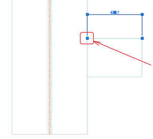

For example, in the following image, the highlighted point belongs to two objects; it is both the plate corner and the nearest point along the beam edge:
For the beam - nearest case, the dimension that accepts that point needs to be perpendicular to that edge, so in the example, the horizontal dimension line has one of the points on two objects.
During update, the Advance Steel mechanism would not differentiate between the two objects, so internally, it would associate the point to one of the objects; if this object is the beam, then the point would jump to the edge corner point, as the Nearest snap is valid, but would not be kept as selected on the screen (during update a point created with Nearest will jump to a nearby corner along that edge).
