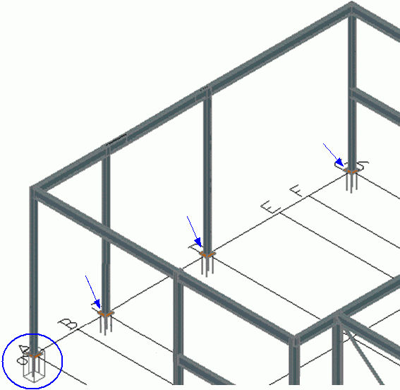

Example:
For the four columns in the image, base plates have been created using the same macro (). The created connections are independent and their properties have been modified separately. You can transfer the properties from one connection (A6) to the other three and obtain identical base plate connections.
