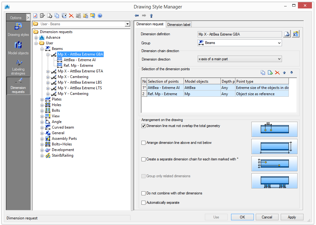

Dimension Definition Properties
Set different options for the dimension direction, selection of dimension points or dimension chain positron by accessing the dimension definition properties.
A dimension definition contains the following settings:
  • Dimension direction - defines the dimension chain direction relative to the applied object type.
  • Selection of dimension points - A list of sub-styles is available for point selection. The sub-styles specify which points from what objects will be dimensioned.
  • Dimension chain position - Several options are available for better positioning relative to the object presentation.
The existing dimension definitions can be renamed and new definitions can be added.
Button Function
Define a new dimension definition. A copy of the current settings is created that can be moved to another group using the Group drop-down list. A new item appears in the tree panel under the specified group.
Rename a dimension definition. The current settings are saved under a different name.
