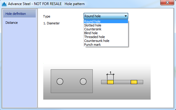

On this tab of the properties dialog box you can select the hole type, define its diameter and set the respective bolt properties for different types of holes.
Select the hole type for the selected element. The dialog box displays the parameters for the selected hole type.
- Round hole
- Slotted hole
- Countersink
- Blind hole

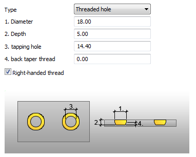

- Threaded hole

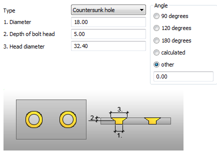

- Countersunk hole

Round hole | |
Diameter | Defines the hole nominal diameter. |
Slotted hole | |

Right-handed thread check box | |
Countersink hole | |
Depth | Defines the depth of the hole. |
Alpha | ![]() |

Threaded hole | |
Countersunk hole | |
