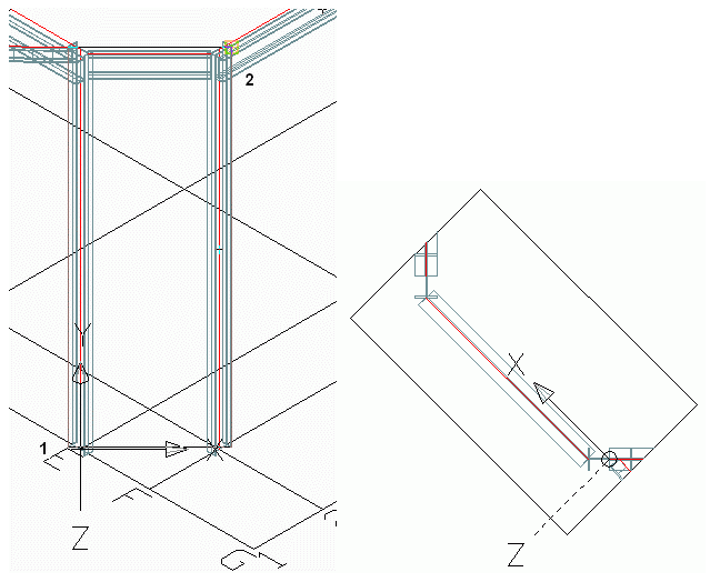

Define a model view by two points
  1. Select a suitable UCS.
  2. In the Quick views tool palette, (Create model views).
  3. In the dialog box, select .
  4. Select two diagonal points in the view plane.
  5. On the command line, enter the front depth and press Enter.
  6. On the command line, enter the rear depth and press Enter.
  7. Enter the view name and press Enter.
  8. A default view box appears with arrows to define the view direction.
  9. Select one of the displayed arrows to define the view direction and press Enter.
  • The model view is created and appears in the Project Explorer.
Example:

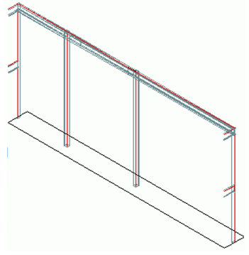

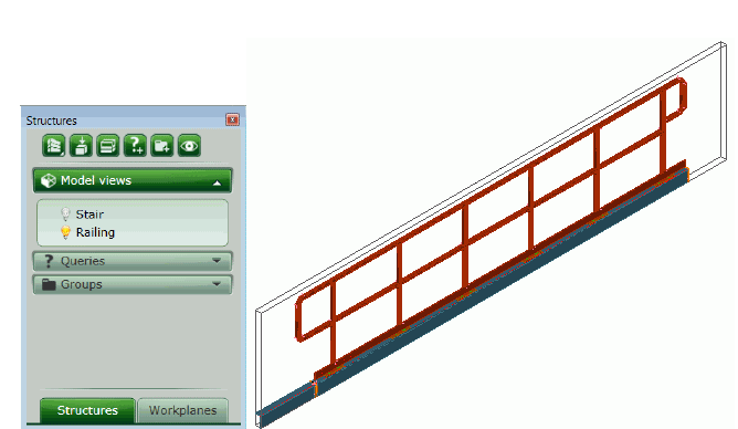

Example: Model view for a railing
