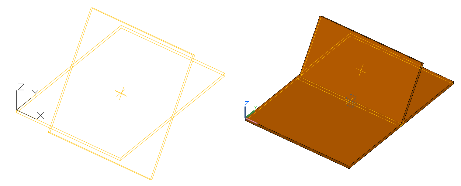

Using this tool, you can cut a plate at another object in the 3D model.
Access the command
Features tool palette: (Cut at object).
Command line:_AstM4CrConByVB
Cut a plate at another plate
  1. From the Features tool palette, select (Cut at object).
  2. In the properties dialog box, select the cut method.
  3. Click OK.
  4. Select the section to cut against.
  5. Select plate to cut.
  • The plate is cut at the first selected object.
