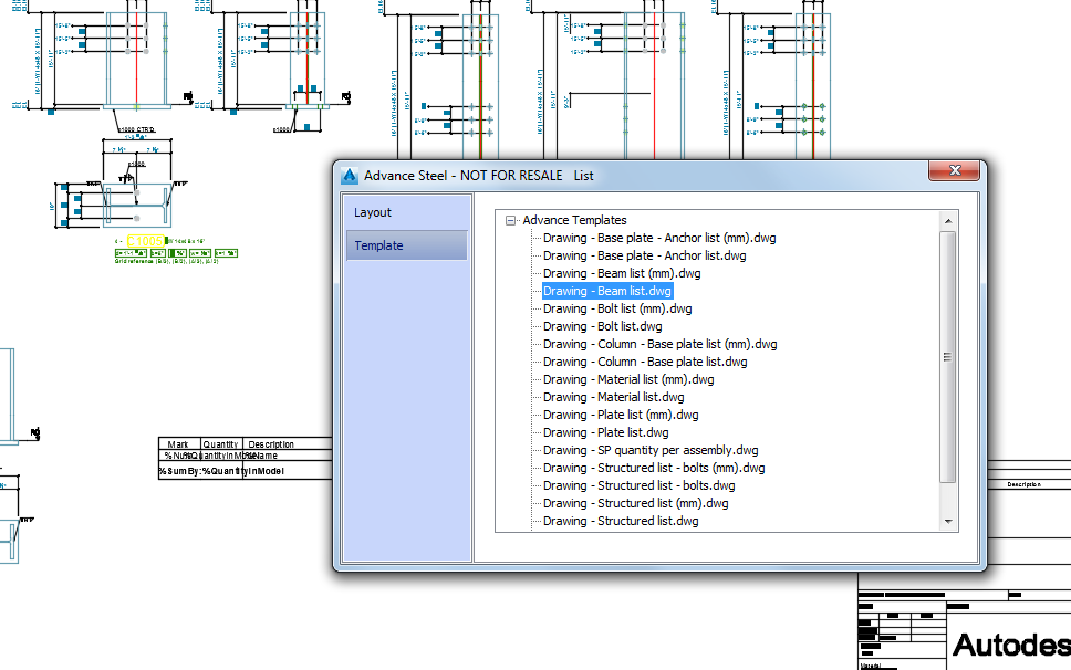

In the Labels & Dimensions tab Management panel, click (Insert a details list).

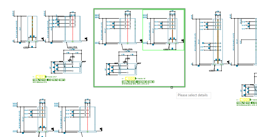

The workflow for creating a list for specific details is very similar to the one for creating a list for the entire drawing. However, before placing the list in the drawing, you need to select the desired details. All elements from the selected details will be evaluated in the list. The selection can include one or more details, including overviews.
Detail Selection
Template Selection

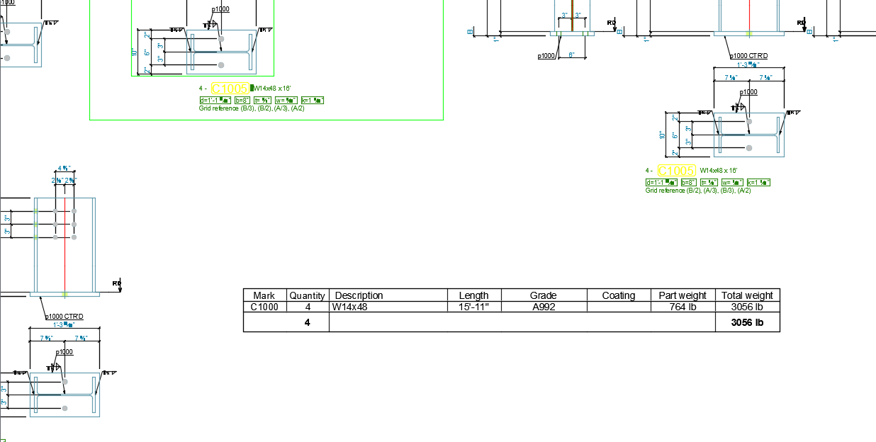

Updated List
