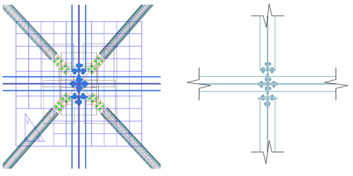

Example
In the case of a camera containing a node where several beams and braces intersect, you can obtain a camera detail drawing showing only the beams and their respective connections:

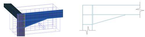

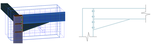

Note: In the case of connections, if the connection box is selected, all the connection elements will appear in the camera detail.
If some of the connection elements (e.g. bolts) do not need to appear in the camera detail, the entire connection box should not be selected - only select the other connection elements except the bolts to be included in the camera selection.
