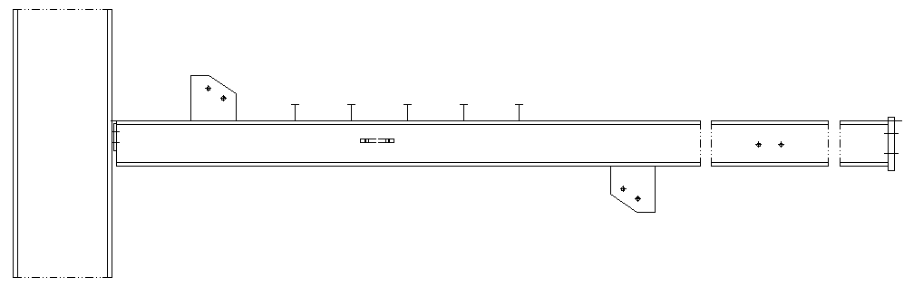

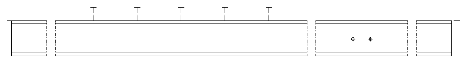

Single part Only the single parts are detailed.
Single part and additional elements Only the single parts and additional elements are detailed.

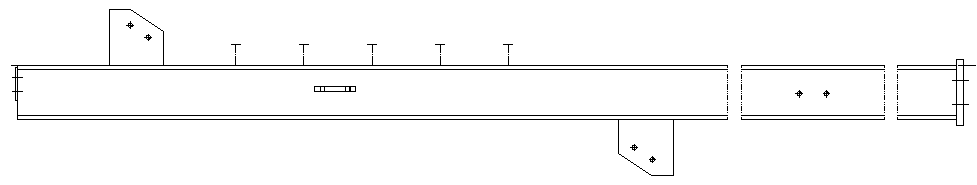

Main part Only the main parts are detailed.
Main part with environment Main part with attaching parts and defined environment. In the model box, a XY- and a Z-viewport must be defined.
Main part and additional elements The main part and additional Advance- and ACIS-solids.
