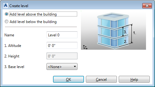

The Create Level Dialog
You can set different parameters for the newly created level.
Command access
To create a new level:
  1. In the Home tab Project panel, click (Project Explorer).
  2. In the Project Explorer Structures tab, click (Create level above).
Dialog Box
Option Description
Add level above the building Creates a level above the building.
Add level below the building Creates a level below the building.
Name The name of the current level.
Altitude Defines the altitude of the current level. The altitude is the distance from the level main workplane to the WCS origin. Negative values are allowed.
Height Defines the height of the current level. The height is the distance between the level main workplane and the base level workplane.
Note: The value must be positive. The height of the level used as reference (the Top Level).
This field is empty and disabled when a base level is not specified.
Base level Select the level to be used as reference for the current level. The list contains all the levels of the current building, in the same order as in the Project Explorer. Modifying the base level does not modify the structure objects currently connected to the level.
