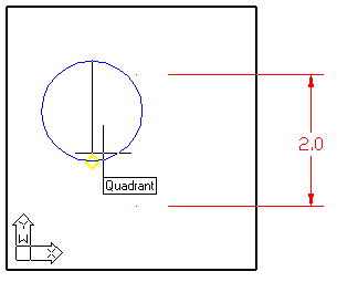

For example, to align a circle in model space with a dimension in paper space, you could follow these steps:
Specify two points in model space:

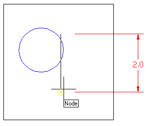

Specify two points in paper space:
The circle is aligned with the dimension in paper space:
