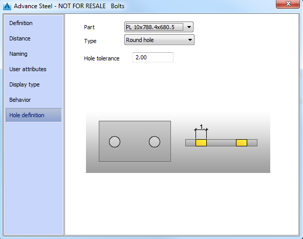

On this tab of the properties dialog box, you can select the type of hole created for the bolts. The parameters change according to the selected hole type.
| Option | Description |
| Part | Displays the list of the elements involved in the connection. The active element is marked. For each element, a different hole type can be selected. |
| Type | Select the hole type for the selected element. The dialog box displays the parameters for the selected hole type. |
| Hole tolerance | Defines the hole tolerance. |
