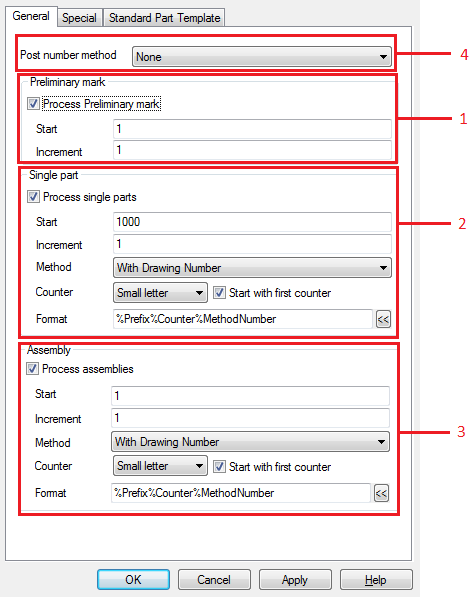

The main numbering dialog consists of four sections used to set up the numbering methods.
Some of the settings found in the Numbering dialog are stored in the default settings (Management Tools / Defaults category). Therefore, these settings can be applied for multiple users, shared through the AstorSettings/Default profiles and migrated to other versions.
Once a numbering method is set, click Apply to save it inside the project DWG file. The numbering method can be reused each time for the respective file, with the same settings (even if you send the file to a different computer that doesn't have the same settings as the initial one).
- Preliminary mark numbering method - This activates the preliminary mark numbering and allows you to set the start mark and the increment. This numbering method is independent of any post-numbering methods or Single Part / Assembly numbering, and can be performed at any point - especially in the preliminary stages of modelling, to allow the creation of raw material lists or general arrangement drawings
- Single part numbering method - This controls the method used to assign automatic numbers to individual part groups. It allows you to set the start mark, the increment and the display layout.
- Assembly numbering method - This controls the method used to assign automatic numbers to assembly groups. It allows you to set the start mark, the increment and the display layout.
- The post numbering method is applied once an initial method is used to assign part and assembly marks and it sets a set of predefined rules.

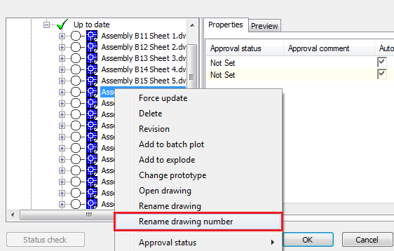

Change part marks using Change drawing number
As a common practice during a project, it is required to change the part mark of certain assemblies or part marks. Because using this method creates a link between the element mark and the drawing number where it is detailed, controlling the part will need an update of the two parameters, so the action in this case is to change the drawing number, which will trigger a change in the part mark.
- In the Output tab
Document Manager panel, click
(Document Manager).
- Browse the drawing list and find the drawing where the object that needs a part mark change is detailed.
- Right-click on the drawing name and select Rename drawing number from the contextual menu.
- Enter the new drawing number. This functionality will:
- not allow you to insert a drawing number that already exists in the project.
- automatically change the part mark (single part or assembly) of the object(s) detailed on the drawing.
- change the file name and use the new drawing number value that is part of the filename.
- Once the drawing number is changed, this file and possibly other files will enter an Update required status, to perform a change in the label for the new part marks.

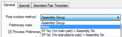

Single part / Assembly post-numbering methods
The post-numbering rules are applied after the initial numbering, changing certain part marks based on the rules to match the definition. They can be used to obtain the numbering as expected.
The post-numbering method is set from the combo box in the top of the Numbering dialog, and offers the following options:
- None
- SP Number (for main part) = Assembly Number
- SP Number (for standalone part) = Assembly Number
- Assembly Group
- None: no post-numbering method is applied. Part numbers and assemblies are numbered separately.
- Assembly Group: this post-numbering method will change all the single part marks to match the assembly part marks, together with an identifier to generate a unique part mark.
