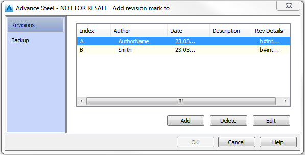

The Revisions Tab
This tab displays the list of revisions added by different users.
Button Description
Add Adds a new revision in the revision list.
Delete Deletes a selected revision from the list.
Edit Allows modifying the revision information in the Revision mark dialog box.

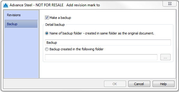

The Backup Tab
This tab allows you to make a backup of the drawing before it is given a revision mark.
Option Description
Make a backup check box Creates a backup of the current drawing before adding the revision.
Detail backup
Name of backup folder Allows entering the name of the backup folder. The backup folder is created in the same folder as the original document.
Backup created in the following folder Allows selecting the backup folder.
