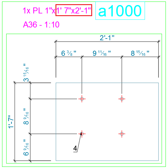

In the following image, the Width and Length values are shown in feet and inches:
Description: D:\B\Documentation\Advance Steel 2016\FAQ 2015.1 [2016]\FAQ images\FAQ- How to set dif units and precision to plate name\plate name width ft inches.png
In this example, the Plate name will be modified to show the width values only in inches (no feet), while the rest of the values will remain in both feet and inches.

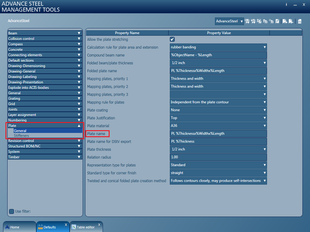

  1. Go to Management Tools Defaults Plate General
  2. Go to the Plate name property:

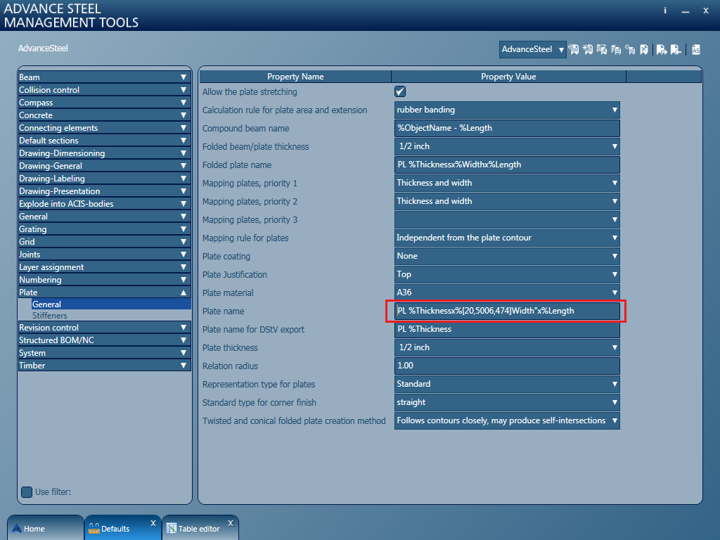

  3. In the Property Value field type PL %Thicknessx%[20,5006,474]Width"x%Length

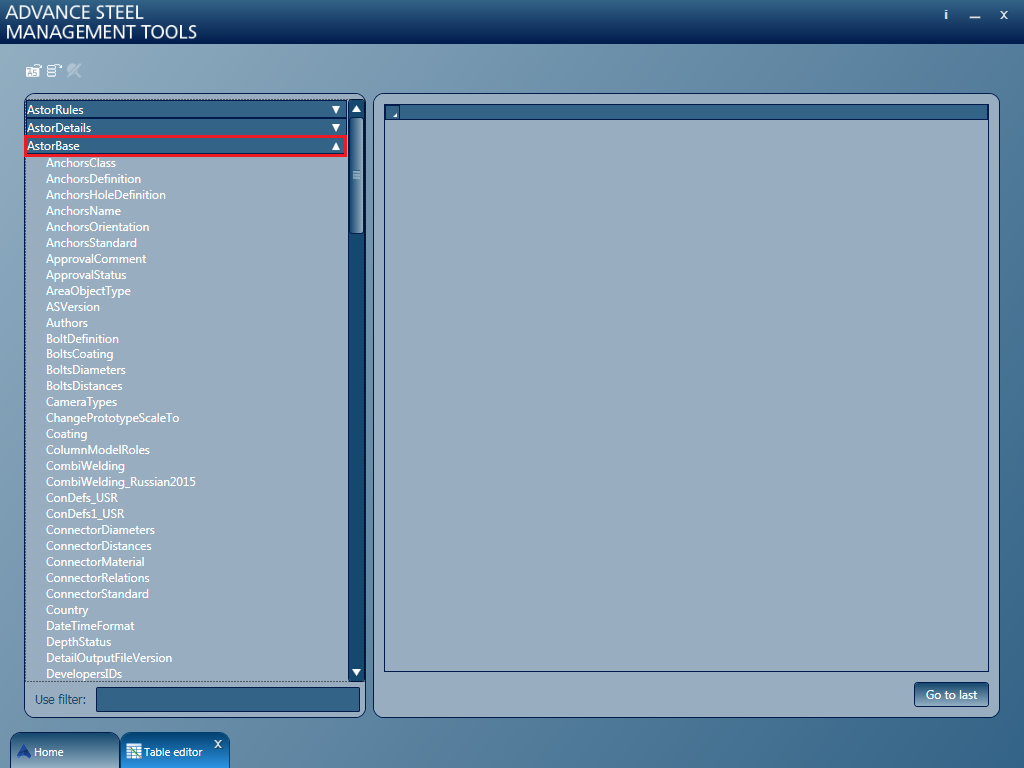

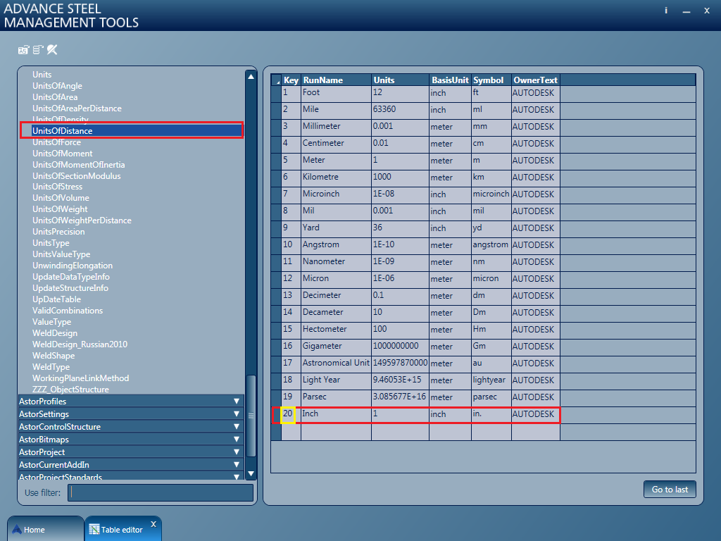

    To find out the keys you need to include in the "[ ]", open Management Tools Open ODBC and browse AstorBase:
  • The first number between “[ ]” is the unit key from the tables in the AstorBase database starting with UnitOf... (e.g. for a distance it is from UnitsOfDistance):

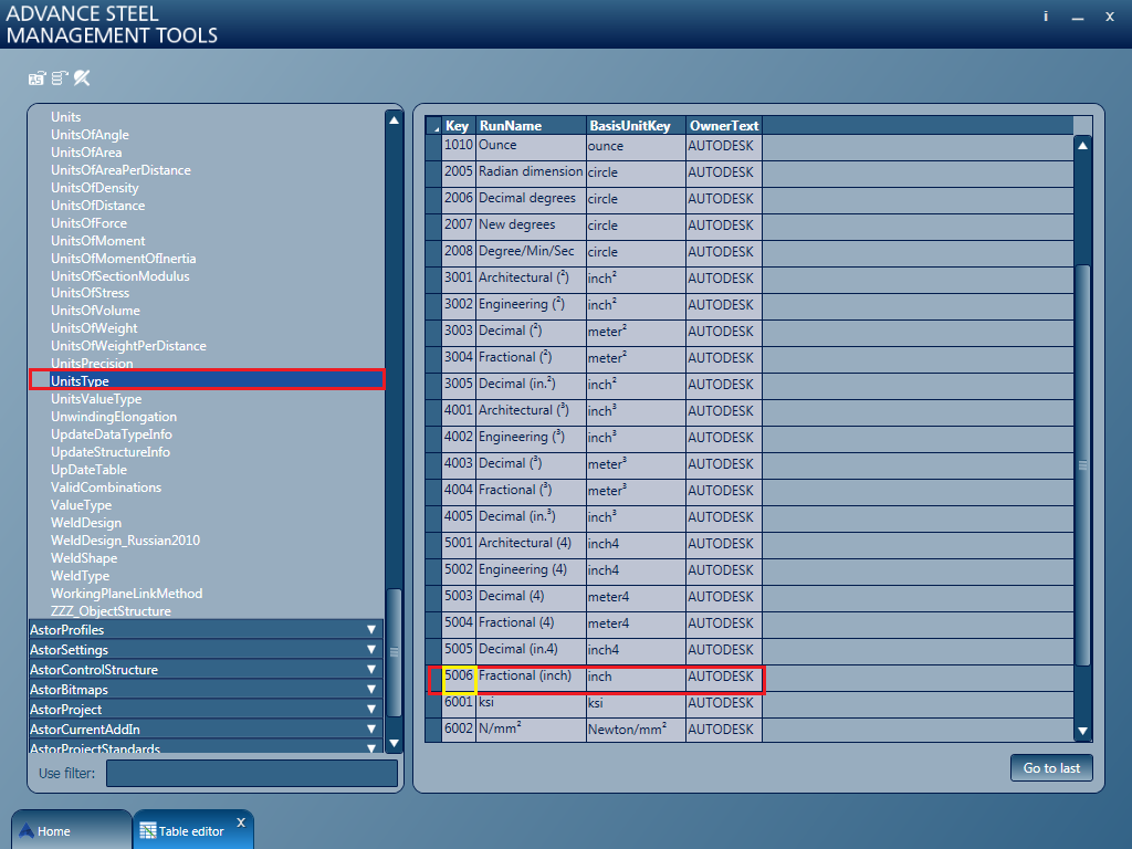

  • The second number is the unit type from the UnitsType table in in the AstorBase database:

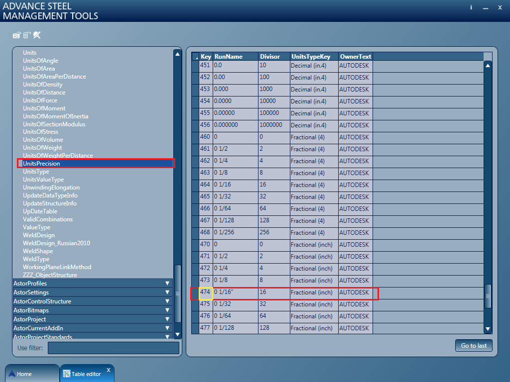

  • The third number is the unit precision from the UnitsPrecision table in in the AstorBase database:
Note: In this example [20, 5006, 474] was used, which means:
  • Key 20 from in the AstorBase database, UnitsOfDistance table: Inch
  • Key 5006 from in the AstorBase database, UnitsType table: Fractional (inch)
  • Key 474 from in the AstorBase database, UnitsPrecision table: Fractional (inch)

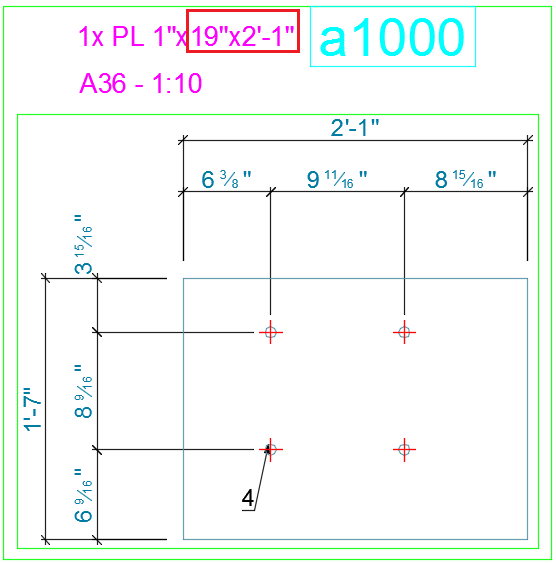

Now, in the detail drawing, the Width is shown only in inches, while the Length is still shown in both feet and inches:
