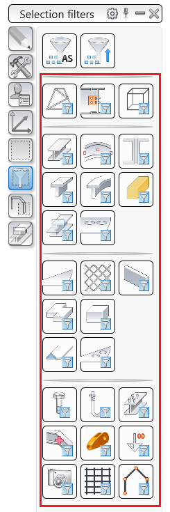

  • Use the following filtering tools from the Selection filters tool palette

Filtering Tools
These tools allow you to filter a set of objects of a specific type (beams, plates, gratings, etc) from the entire model or from a selection. You select the object type from the selection that you want to filter using the Selection filters tool palette.
To access the command
Selection filters tool palette: Select the desired element type.
Command line: _AstM4SelectObjectByName [type of object]
To filter an object selection
  1. Select a group of Advance objects using one of the selection methods.
    Note: If there is no selection, the filter applies to the entire model.
  2. From the Selection filters tool palette select the object type to filter. For example, for beams Click .
  3. Only the filtered objects are selected (in this case, the beams).
