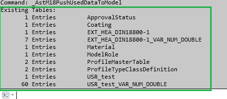

- The table entries that correspond to the used parameters will be appended to the respective DWG.
- A list of the database tables that are now stored with the DWG will be shown in the command line:
- Save the DWG file to finalize the process.
