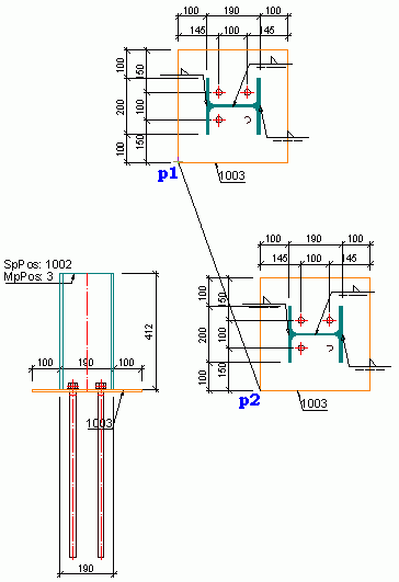

  1. Open the detail drawing.
  2. In Labels & Dimensions tab Parametric Views panel, click (Move view).
  3. Select the view to move.
  4. Select the reference point for the view (P1).
  5. Select the second point (P2).
The selected view is moved to a new location, determined by the position relative to the reference point and the distance and direction determined by the two points.
