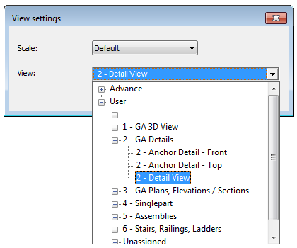

    2. Using the S key, you access the View settings dialog that contains the overrides for the view request and scale used by Advance Steel to generate the callout view.
      Option Description
      Scale This combo box contains all the scales available in Advance Steel and one default scale. The default scale is an intelligent setting that uses the scale of the view selected for the callout view. Using the default scale allows you to create callout views (that use the scale of the main view) faster, without the need to manually match them afterwards. The Scale field is set to Default. Once you change the scale from this dialog, the change is saved and can be reused for other callouts created afterwards, until the dialog is accessed and the scale is changed again. Advance Steel memorizes the last used scale until you close the software, defaulting back to the Default value when you reopen Advance Steel.
      View This combo box contains a list of all the view requests available in Advance Steel - that are used when generating callout views.

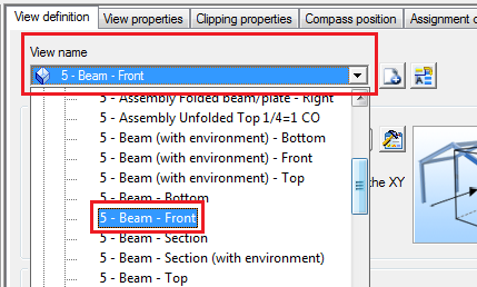

      You can find the list of view requests available for manual cuts in the Drawing style manager, at the following level:
      In the View settings dialog View combo box, you can choose between the Advance and User view categories:

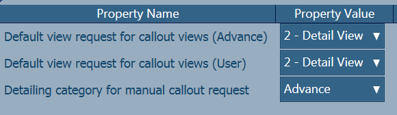

      By default, Advance Steel sets the view request from a series of defaults found in the Management Tools application:
      • Default view request for callout views (Advance)
      • Default view request for callout views (User)
      • Detailing category for manual callout request
      Once you change a view request from the list, it is saved in the local memory and reused for the callout view command until you exit Advance Steel, similarly to the scale setting.

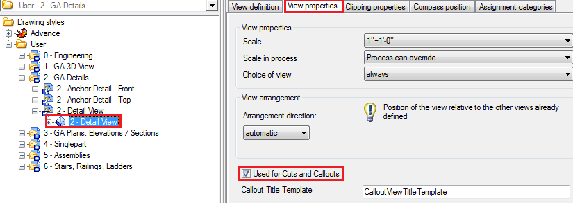

Customize the preferred list of detail view requests used by the callout command
You can set the preferred view requests that will display in the Settings / View settings dialog. Using this type of configuration will make available a short list of view requests when creating the callout views (and also manual cut views).
To add a specific detail view request to the preferred for Cut / Callout view list:
  1. Open Drawing Style Manager and select the specific view.
  2. On the View definition level, access the View properties tab.
  3. Check the Used for Cuts and Callouts option.

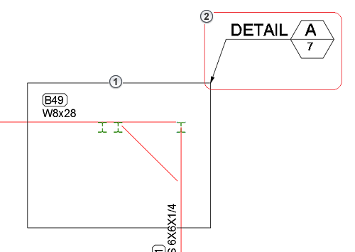

Callout symbol representation on the main view

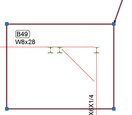

When a callout view is created, a callout symbol is also inserted on the main view. This symbol is composed of a frame ( ) that defines the border of the selected callout view size and a label symbol ( ) that can display information about the view:

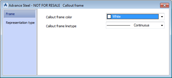

You can edit the callout frame by accessing the Callout frame dialog: right-click on the callout symbol and select Advance Properties from the contextual menu to open the dialog.
In the Frame tab you can change the color and line type of the boundary rectangle.
In the Representation type tab you can change how the frame is drawn:

The callout frame symbol also offers 4 grip points, which you can use to change the size of the callout view once the callout is created.
Note: The drawing requires an update to adjust the callout size, once the resize is done.
You can configure the default settings for all the options available in the Callout frame symbol dialog, using the Management Tools application Defaults category, using the following properties:
  • Drawing-Presentation Colors Callout frame color.
  • Drawing-Presentation General Callout frame representation mode.
  • Drawing-Presentation Linetypes Callout Frame linetype.
The callout symbol on the main view is created using a customizable template, and is automatically inserted every time a new callout is created. It is automatically positioned in the top-right corner of the callout frame. Similarly to labels, you can change the position of the callout symbol, by using the two grip points.
- Moves the callout symbol label.
- Changes the position of the leader line arrow.
The position of the symbol is kept during update, and the automatic positioning on the top-right corner during the initial creation of the callout view will no longer be taken into consideration.
