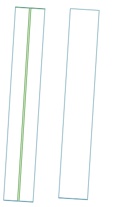

Show hidden lines checkbox If checked, the hidden lines of the detailed elements will be visible in the respective detail view.
