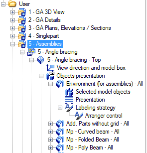

The following image highlights the layout structure of a drawing style:
Selected model objects, presentation and labeling strategies are core settings which directly communicate with Advance Steel, while the upper settings in the tree are saved rules that reuse certain configurations. Editing any settings of an existing drawing style requires a set of copies of the rules that are above that respective setting, including the drawing style itself.

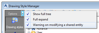

Note: The Drawing Style Manager does not mention on which drawing style a certain setting could be used. It is strongly recommended to have the Warning on modifying a shared entity option checked, in the Drawing Style Manager dialog Options menu:

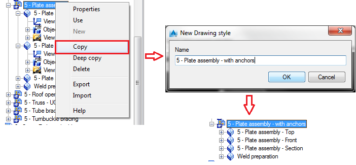

  1. Make a copy of the drawing style. Select the style, right -click and choose Copy from the contextual menu. Always use Copy instead of Deep copy. The copied drawing style will keep the existing views and settings, so at this point there is no difference between the two styles, except the name.

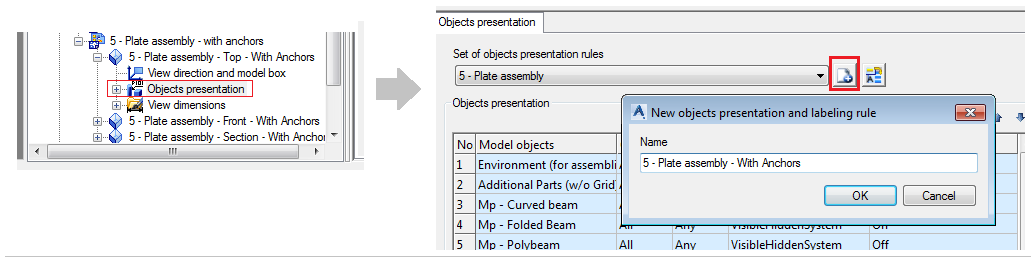

  3. Expand the Object presentation page for the first view and create a copy of it.
  4. Add the Anchor presentation rule to this object presentation.

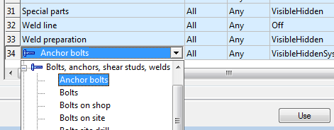

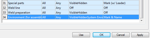

  5. Click (Add a new object presentation). This will add a new line at the bottom of the list, containing values copied from one of the existing entries (generally the first line is copied). The object presentation rule will contain a duplicate entry. The new line will store the necessary modifications to add the anchor object to the plate drawing style. You can reuse existing configurations to add the anchor as they are core settings which do not require a copy.
  6. Specify the model objects as anchor bolts.
  7. Leave both the Geometric restriction and Depth position values to All.

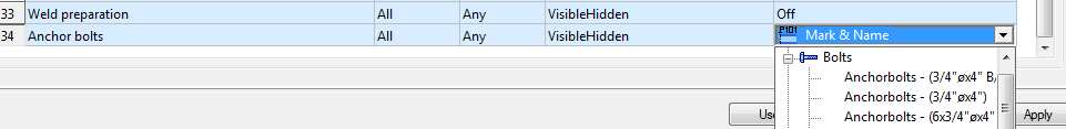

  8. Set Presentation to detail the anchors. For example set it to VisibleHidden which will detail the anchors with their full graphic representation.
  9. Specify a labeling strategy for those anchors under the Bolts category. If no label is required, select Off.
  10. Click Apply to save the settings.
