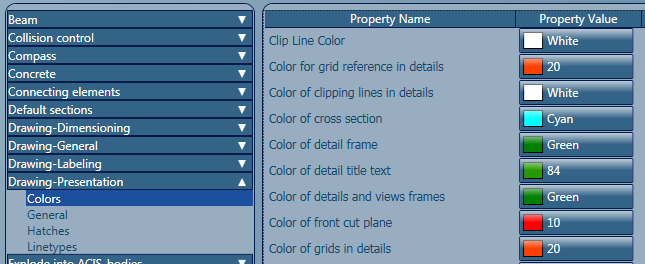

For all single part and assembly drawings, the color of the objects is based on line type. The same color is used for the visible lines of any object, without differentiating between beams, plates or bolts. These colors are specified in the Management Tools application, under the Drawing-Presentation/Colors category. You can specify colors before or after the drawing is created. Updating the drawings will always use the current setting of the color defaults:
