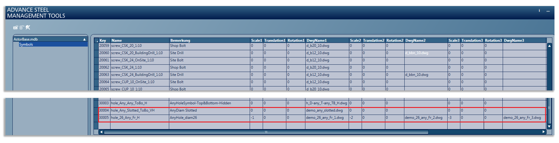

This is how the two example hole symbol configuration lines appear in the Symbols table:
