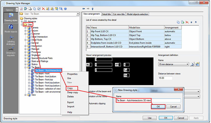

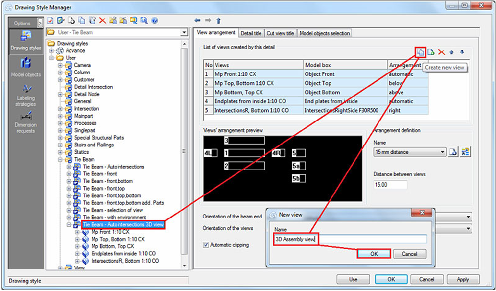

  1. In the Output tab Document Manager panel, click (Drawing style manager).
  2. In thw Drawing Style Manager, from the User category copy the Tie Beam - AutoIntersections drawing style and name it Tie Beam - 3D view.

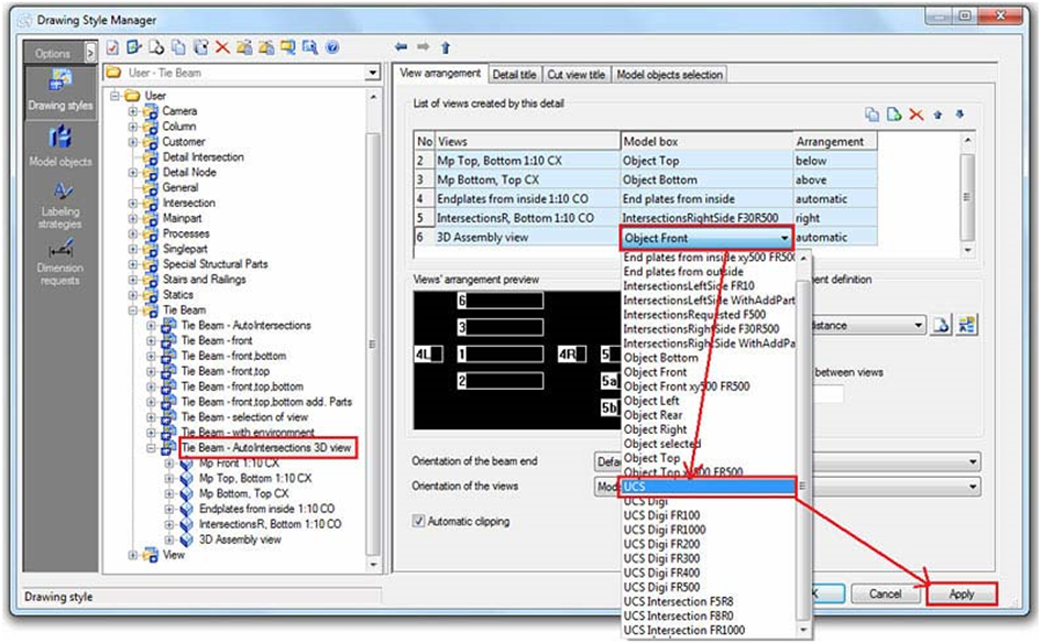

  3. Create a new view and name it 3D assembly view.
  4. For the newly created view, change the view direction and model box name to UCS. Click the Apply button to save the changes and close the Drawing Style Manager.

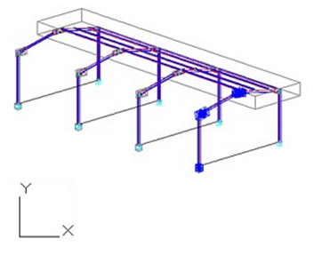

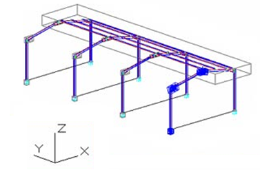

  5. Rotate the model in the desired position you want to see the rafter beam in and change the UCS to View. The isometric view is UCS dependent and is created from the positive Z direction.
      UCS - View

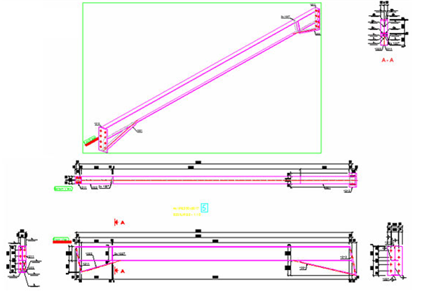

  6. Open the Drawing Style Manager, select the drawing style you have modified and click Use. Select the rafter you want to detail.
    Note: The model must be numbered before you create the drawing.
  7. Model Detail
