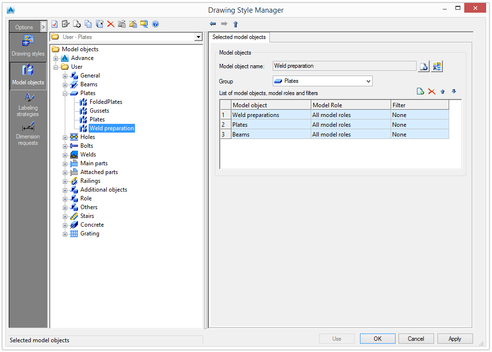

Model objects act as filters for objects from the 3D model. A model object is defined by the object type (e.g. Beam), model role (e.g. Column) and an additional filter (e.g. with holes).
Add / rename model objects
The list of model objects, roles and filters can be modified. New strategies can be added or existing strategies can be renamed.
Button | Function |
Define a new model object. A copy of the current settings is created. It can be moved to another group using the Group drop-down list. A new item appears in the tree panel under the specified group. |
Rename the model object. The current settings are saved under a different name. |
Manage the list of model objects
The toolbar contains all the necessary management functions:
Button | Function |
Add a model object. |
Delete the selected model object. |
Move the selected model object up the list. |
Move the selected model object down the list. |
