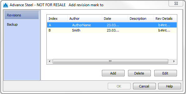

The Revisions Tab
This tab displays the list of revisions added by different users.
Button | Description |
Add | Adds a new revision in the revision list. |
Delete | Deletes a selected revision from the list. |
Edit | Allows modifying the revision information in the Revision mark dialog box. |

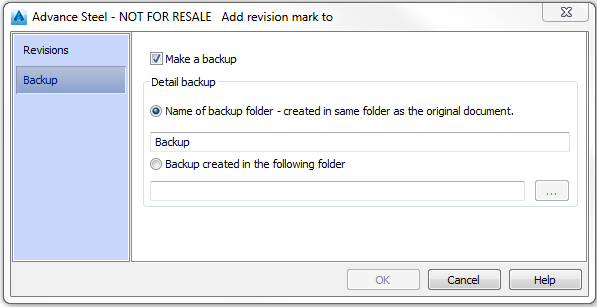

The Backup Tab
This tab allows you to make a backup of the drawing before it is given a revision mark.
Option | Description |
Make a backup check box | Creates a backup of the current drawing before adding the revision. |
Detail backup | |
Name of backup folder | Allows entering the name of the backup folder. The backup folder is created in the same folder as the original document. |
Backup created in the following folder | Allows selecting the backup folder. |
The Revision Mark Dialog
Allows you to enter information about the revision (revision data, author, etc.). This information will appear in the revision table.
