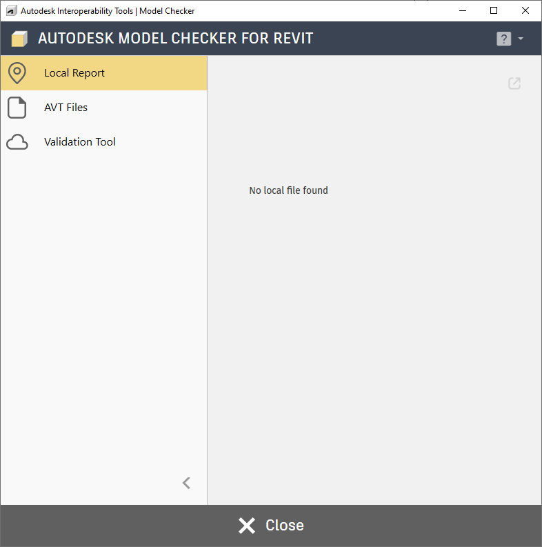

Model Checker Ribbon
To open AVT reports in Revit using Model Checker for Revit, click View Report. This will open a new dialog.
Model Checker View Reports

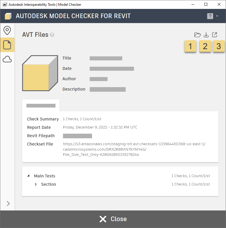

AVT Files
This section provides the ability to open AVT files, import, and open in a new window.
Model Checker AVT File Open
  1. This provides the ability to open AVT files that have been downloaded from AVT's website. The AVT files does not need to be associated with the current Revit model.
  2. This imports the current AVT file into the current Revit Model and sets it as the local report. This will overwrite any existing reports.
  3. This opens the report in a new window to allow for comparing reports.
    • Remember that Revit opens the current model whereas AVT opens the published model.

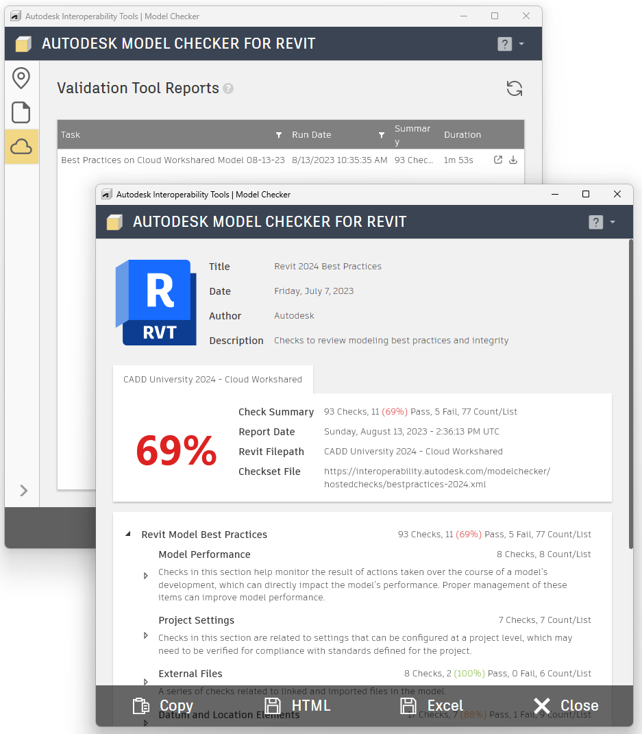

Validation Tool
This section will list AVT reports that you have run on the current model.
Model Checker Validation Tool
  1. This opens the report in a new windows.
  2. This imports the report into the current Revit model and sets it as the local report.
