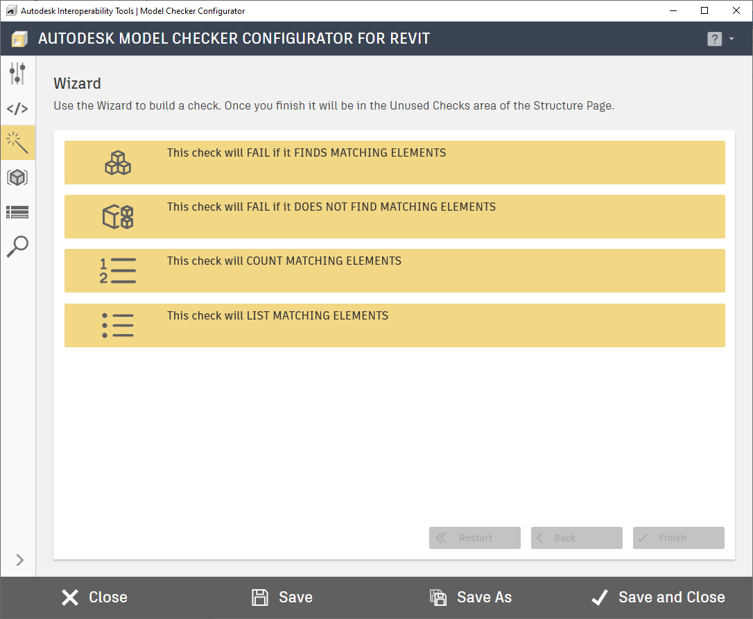

The Wizard will prompt you with a series of simple questions that will guide you through the creation of a check, with the appropriate configuration and filters.
ART Task Name
Using the Wizard: The Wizard has a simple consistent interface, allowing you to go back through the creation process, or even start over from the beginning if necessary. The first question is how do you want the check to operate, see Check Result above for a description of each of these. Depending on your selection, you will be given a series of other questions. When the Wizard has enough information from you, you will be asked if you want to finish and name your check, or continue adding to it. Adding a filter, will continue to refine the criteria you have already created. Adding another filter group will create a separate collection of filters that is collected under the same check as before, but has its own criteria.
Once the check is complete and you finish, you cannot return to the Wizard. All follow-up work and changes must be done through the Advanced Check Builder page.
