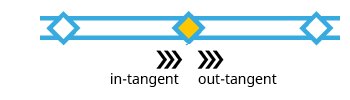

Tangents describe how an action is interpreted between the keyframes that you have set.
Each keyframe has two tangents, an in-tangent and an out-tangent. These tangents describe the behavior of the action on the left (in-tangent) and right (out-tangent) sides of a keyframe.

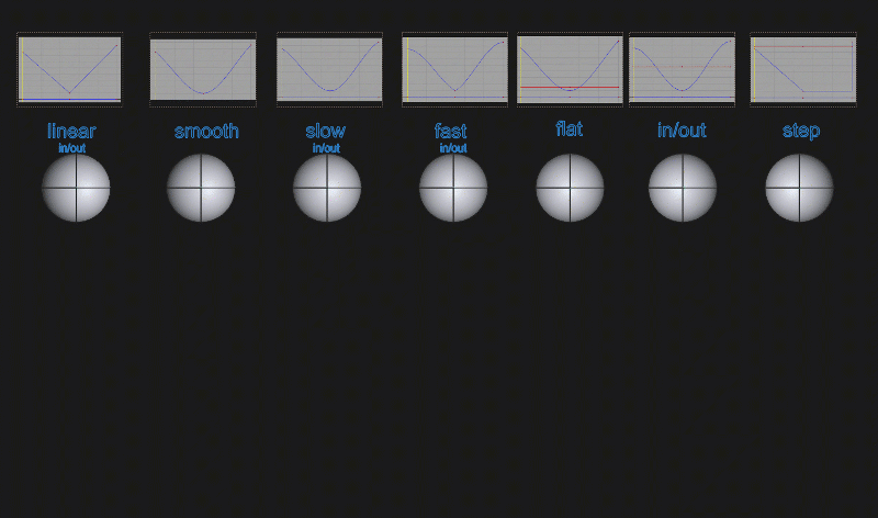

Keyframe Tangent Types set the in- and out-tangent for the selected keyframe only.
- Smooth – Gives a straight-line result between only 2 keyframes, or a Bezier curve through 3 or more keyframes. This avoids jerky motion, but it can sometimes result in an overshoot of an animated value.
- Flat – The rate of change is flat either side of the keyframe slowing the motion as it comes into and out of the keyframe.

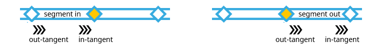

Segment Tangent Types - Sets the in- and out-tangent for the segments leading into or out of the keyframe.
- Linear Seg In/Out – Rate of change is a straight line from the the selected keyframe to the next/previous keyframe, giving a constant motion.
- Fast Seg In/Out – Rate of change is accelerated at this keyframe, setting the next/previous keyframe to slow seg in/out.
- Slow Seg In/Out – Rate of change is slowed at this keyframe, setting the next/previous keyframe to fast seg in/out.
- Step (out-tangent only) - Values don't change until the next keyframe when the motion or parameter jumps to the next setting. Useful for visibility on/off.
- In/Out – Applies a flat tangent type to both ends of the segment.
Examples of Tangent types:
