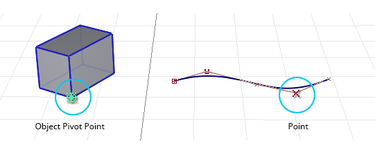

The point being moved or placed will be either:
  • The pivot point of an object (surface, subdivision, group, curve etc.). The pivot point is displayed in green only when the object is selected.
    See Transform > Set Pivot for how to position the pivot point. Snapping is also typically used for moving pivots to accurate positions on geometry.
  • A control point (CV, edit point, blend point, keypoint).

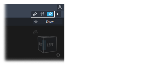

Snap Lock icons
The snap lock icons are at the top of the screen, to the right of the promptline.
Click on one of the icons to turn on it's snapping mode - it will stay applied until it is unselected.
This can cause unexpected behavior if you have forgotten that they have been applied. Most users therefore prefer to use the Ctrl and Alt keys as they only apply while the key is being pressed.
If you get any unexpected behavior during placement or transform, check the snap icons to make sure they haven't been applied (they will be highlighted in blue).

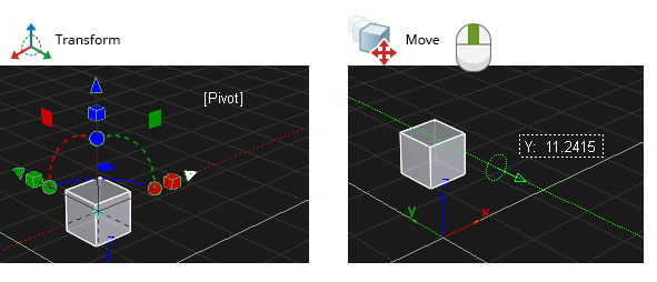

This works slightly differently depending on whether you are working with the Transform manipulator or the Transform Move tool.

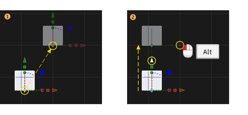

Constrained snapping with the Transform manipulator
The red-x, green-y, blue-z move arrows can be used to limit the movement in one direction. These work with snapping as long as the snap keys are applied before the arrow is selected and moved.
Using the Transform tool:
  • Select the object to move, and then select Transform > Transform to display the manipulator.
  • First, press the required snapping key(s): Alt, Ctrl or Ctrl + Alt, and keep them pressed.
  • Select the axis arrowhead (red-x, green-y, blue-z) for the direction you require.
  • Keeping the snapping keys held down, move the cursor to the required target.

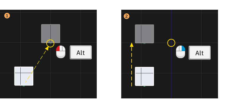

In the examples below:
  1. The free movement handle is selected, so grid snap moves the object exactly onto the grid intersection.
  2. The y-handle is selected, so grid snap only moves in the y-direction to align with the grid intersection location.
  1. The LMB is used, so grid snap moves the object exactly onto the grid intersection.
  2. The RMB is used, so grid snap only moves in the vertical direction to align with the grid intersection location.

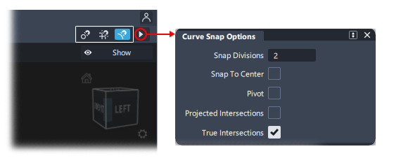

Curve Snap options
The Curve Snap Options window is accessed from the arrow icon to the right of the snap lock icons.
The settings create additional snap locations when curve snap (Ctrl + Alt) is used:
Snap Divisions
You can snap to the midpoint, 1/3, 1/4, etc. by setting Snap Divisions to a value from 0 to 100. For example, setting this value to 2 and then using curve snap gives you a 'snappable' point (shown as a light blue line segment) halfway along the curve. The arc length of the curve or surface is used to calculate the divisions.
Snap to Center
When this option is turned on and you click on a curve, the center of the curve's bounding box is displayed as a small cross surrounded by a circle. Moving the cursor in close proximity of the center icon lets you snap to it.
Pivot
When this option is turned on and you click on a curve, its pivot is displayed. Moving the cursor in close proximity of the pivot icon lets you snap to it.
You can snap to both the scaling and rotation pivots (if they are not in the same location).
Projected Intersections
When this option is turned on, you can snap to the intersection points between curves in any orthographic or perspective view, even if the curves don’t truly intersect in world space. These intersection points are displayed as pink crosses.
Note: If the model contains a lot of geometry, snapping to projected intersections may take a few seconds to occur.
True Intersections
If this option is turned on, then:
  • Curve snap will automatically snap to all intersections between free curves, surface edges, isoparms, curves on surface, and trim edges.
  • Curve snap will automatically snap a new curve-on-surface (CoS) to CoS-CoS intersections on the same surface.
