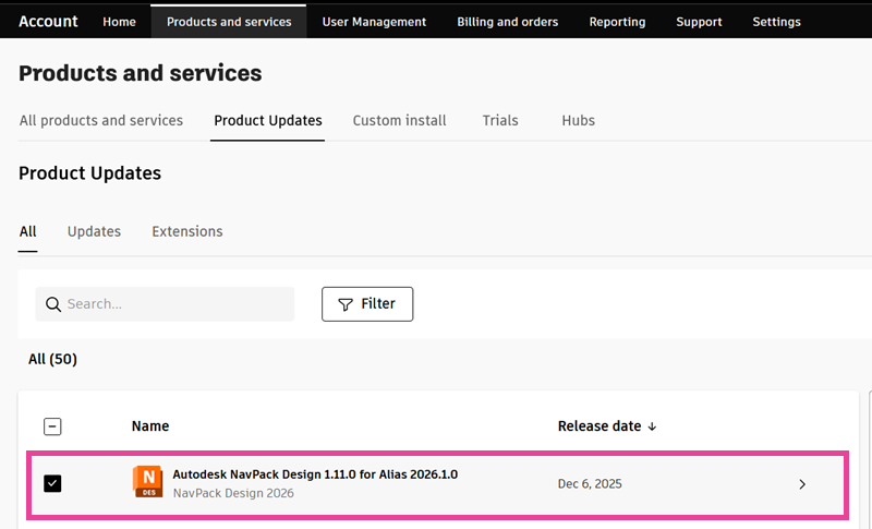

Go to manage.autodesk.com and look for "NavPack Design". If the plug-in does not show up, you may not have access yet. In that case you can reach out to your Autodesk account representative to inquire about access to NavPack Design for Alias. If it does show up, proceed.
Manage Accounts Page
  1. Download the plug-in installer.
  2. Quit Alias if it is running.
  3. Once the download finished, locate and run the installer on your computer. The file to run is called Autodesk_NavPack_Design_1.11.0_for_Alias_2026.1.0_Enu_Win.exe.

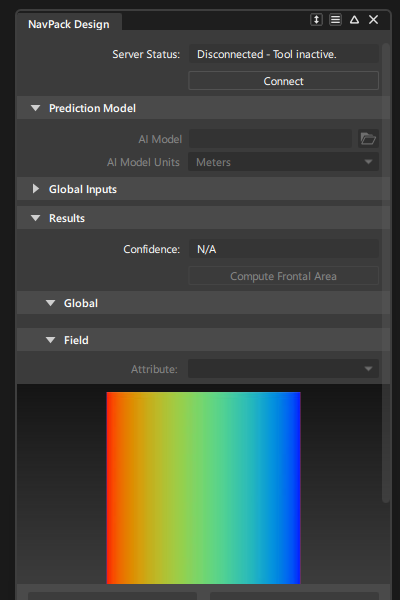

Open the NavPack Design options window
  1. Select Option, double-click the tool itself, or Shift + click the tool.
    The NavPack Design window should appear.
    Locate navDesign Tool

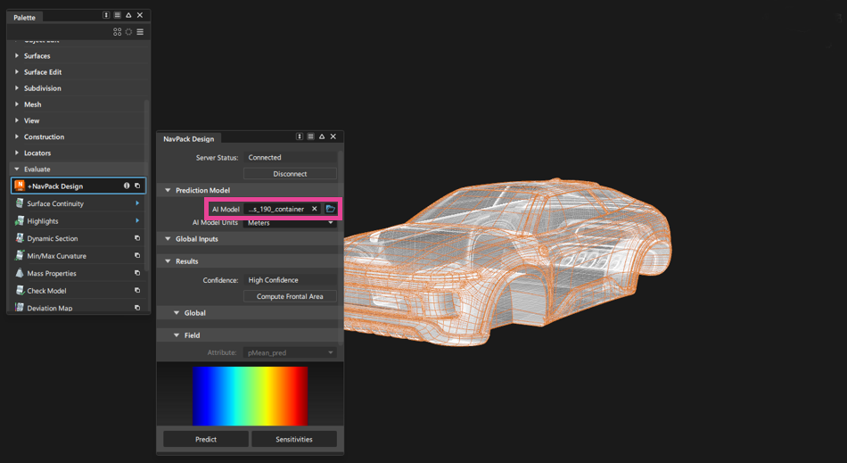

Use NavPack Design
  1. Select the .container AI model by clicking the folder icon.
  2. Beside AI Model click the browse icon: , then select the .container file to load the model.
  3. Select the AI Model Units to use from the list.
    Note: Input is suppose to be a single mesh object. For detailed instruction, see Getting Started with NavPack Design.
  4. Select Predict to run the inference.
