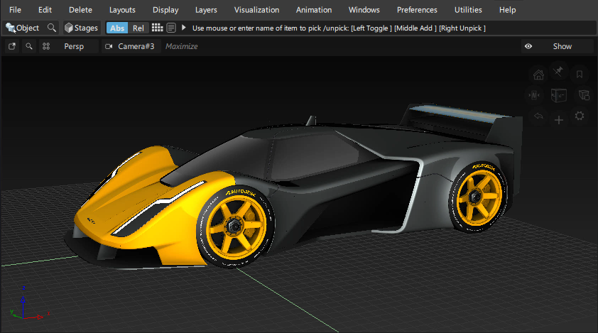

Perspective
Lets you fill the screen with a Perspective view window.

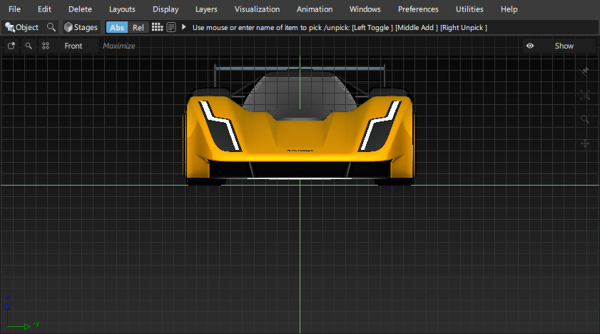

Front
Lets you fill the screen with a single Front view window. This window looks at the -Y, Z plane.

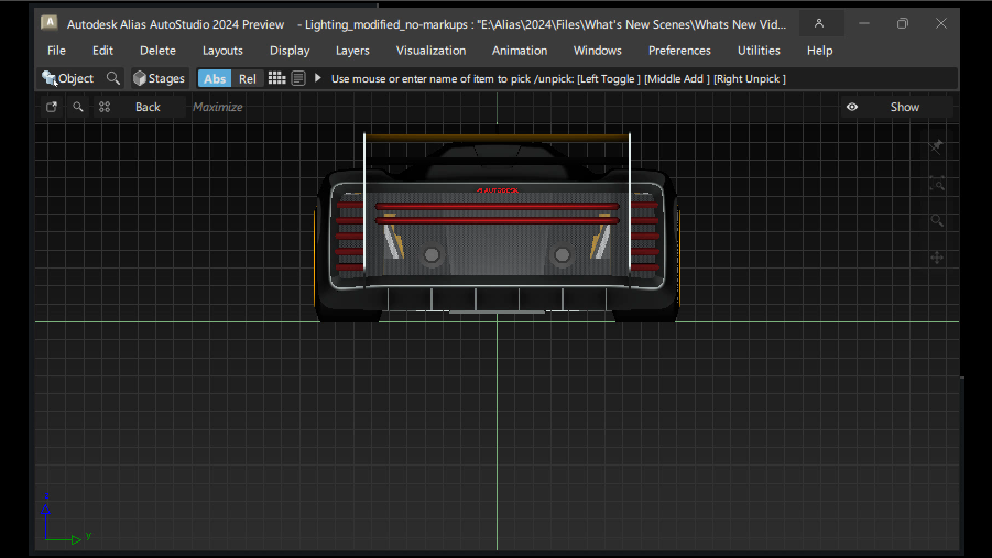

Back
Lets you fill the screen with a single Back view window. his window looks at the Y, Z plane.

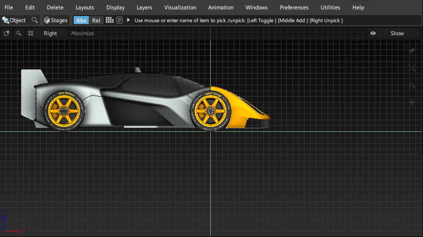

Right
Lets you fill the screen with a single Right view window.This window looks at the -X, Z plane.

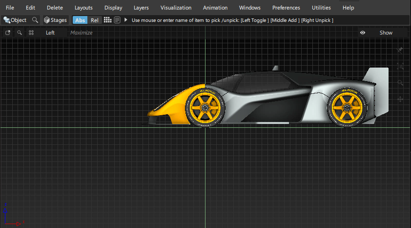

Left
Lets you fill the screen with a single Left view window. This window looks at the X, Z plane.

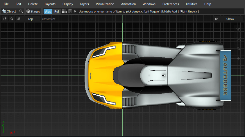

Top
Lets you fill the screen with a single Top view window. This window looks at the X, Y plane.

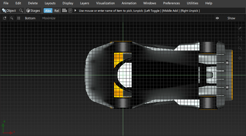

Bottom
Lets you fill the screen with a single Bottom view window. This window looks at the X, -Y plane.

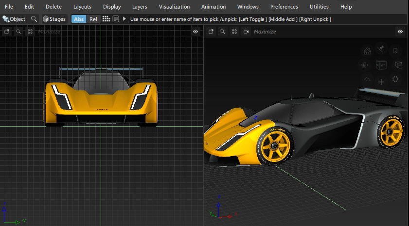

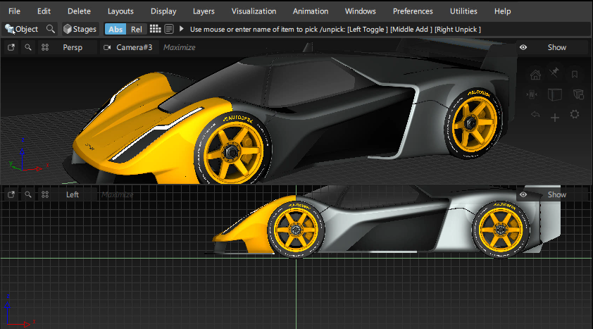

Two Panes Side by Side
Two Panes Stacked

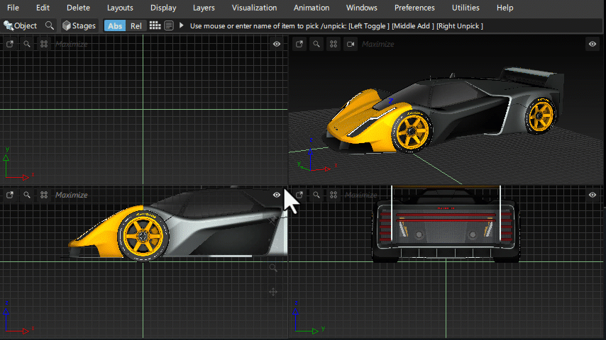

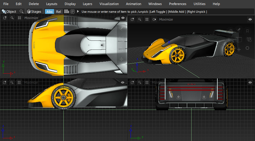

Four Panes
Use the F9 hotkey to toggle between one view window and four.
