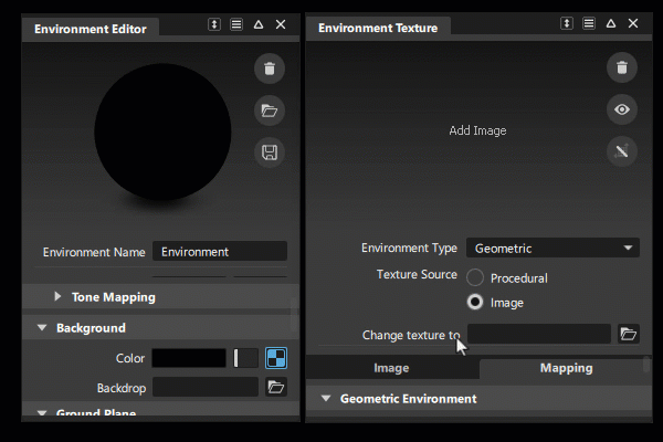

Use the Environment Editor to create, edit, and switch between environments in your scene. After creating an environment, you can adjust its settings to control appearance and properties such as lighting, shadows, reflections, and other effects that enhance photo-realism in Hardware Shade mode.
Environments can range from simple colored backgrounds to complex 3D textures and often include shaders, reflection maps, textures, and background images. You can add multiple environments to the list in the Environment Editor by dragging them from the Shader Library to the Shader Lister or by creating new ones. Select environments to quickly switch between them and present different lighting and background setups. This is especially useful when combined with Variants or if you use Live Referencing in your workflow.

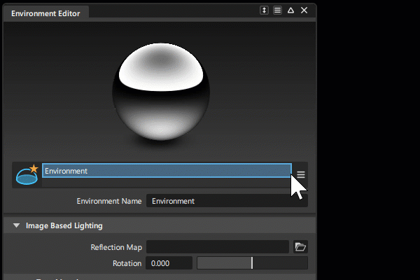

More menu
These options are also available by right-clicking the environment name.

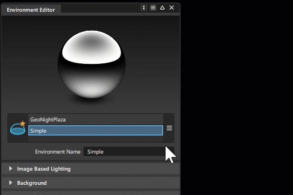

  • Save Environment As - Save the current environment shader with a new name.
  • Create Environment - Create a new environment shader for use in the scene. When prompted, browse to the location of the .hdr image you want to use, then adjust the environment attributes. The new environment is created and becomes active in the scene. Switch between environments by selecting them in the list. For more information, see Add an environment shader to the scene.
  • Import Environment - Imports an environment shader from a location on disk.
  • Delete - Deletes the selected environment shader from the scene. Note that this does not delete the shader from the Shader Library.
Note: You can also access these options by right-clicking the environment name in the Environment Editor.
Note: If you are working in VRED Render mode, see VRED Environment Settings information about environments.

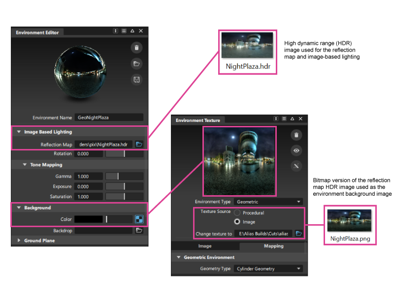

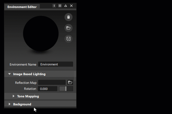

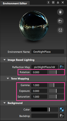

Environment shader: Basic parameters

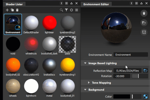

Image Based Lighting

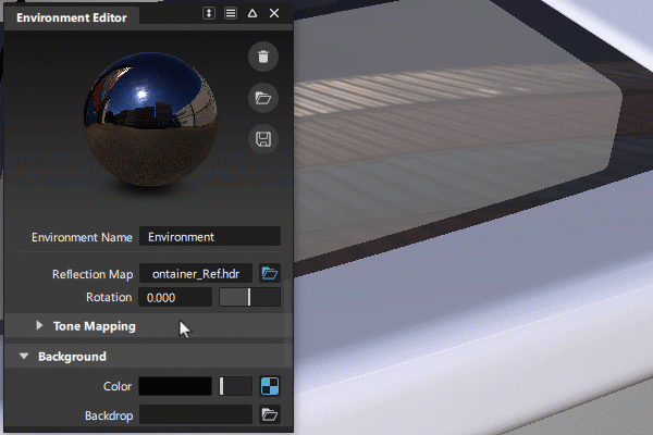

Reflection Map
Either type the full or relative path to the High Dynamic Range (HDR) image to be used as a reflection map or click the file browser icon and navigate to the file. HDR images are the only type of image allowed to be used as reflection maps for Image-Based Lighting.
HDR images can be created using Adobe Photoshop software or purchased from HDRIshop. Some free images are available on the Internet as well (search for “royalty-free HDR images”).
  • Rotation - Rotates the image so that he objects reflect different parts of the image.

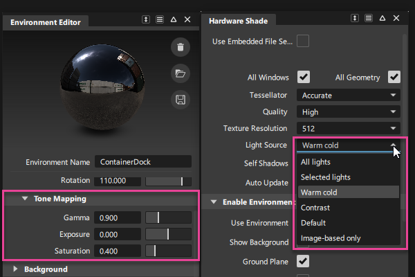

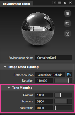

Tone Mapping
The contribution of image-based lighting to illuminating the model can be controlled by tone mapping. HDR images, since they have a wide range, may produce a resulting image that may need to be "toned" to represent lighting that is suitable for the scene. The tone mapping does not affect regular lights.
As with digital photography and images that are higher than 24 bits, the longer the original data is maintained and the later in the process that it is reduced to 24 bits, the more value the high dynamic range data can contribute to the final image.
  • Gamma - Sets the brightness of the mid-tone values of the reflection map. Lower values create darker reflections; higher values create brighter reflections.
  • Exposure - Sets the overall brightness of the reflection map. Lower values reduce the exposure of the image; higher values increase the exposure compensation.
  • Saturation - Sets the amount of color in the reflection map that will be used.

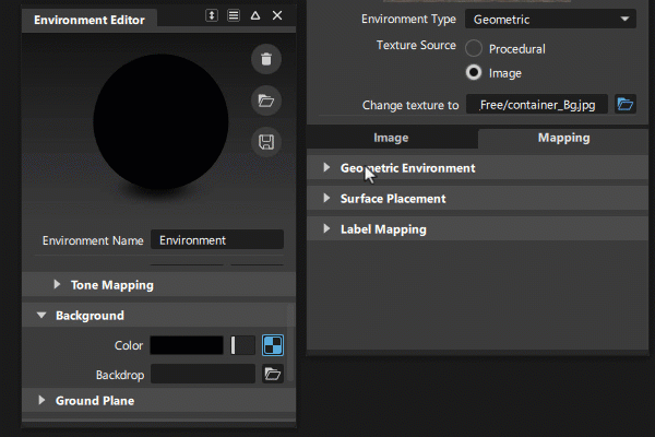

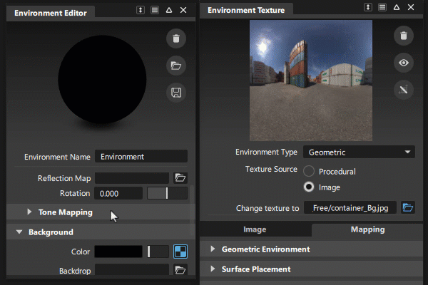

Background
Specify the appearance of the environment background, and optionally specify an environment map for reflections.
Color
The color of the background. The default setting is black.
If a Backdrop image has been specified, it overrides the color.
If this parameter is texture mapped, then the Environment texture selected is used to create reflections on surfaces.
Backdrop
Browse to the location of the image file or series of image files, to use as a background.
Backdrop Fit
Lets you choose how to fit the background image in the viewport. This option only applies to Alias Render mode.
  • Fill - Fits the image so that it fills the viewport horizontally and vertically. If needed, the image width or height is stretched to fill the viewport window.
  • Horizontal - Fits the image to the width of the viewport, while maintaining the image's aspect ratio.
  • Vertical - Fits the image to the height of the viewport, while maintaining the image's aspect ratio.

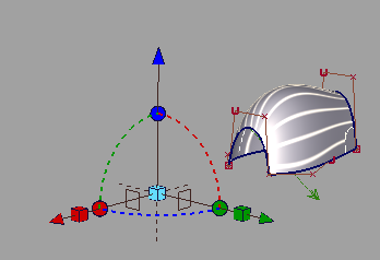

Interactive Placement
Click Interactive Placement to place and scale the size of the light tunnel using the interactive placement manipulator.
  • To scale the tube, move one or all of the three cubes.
  • To rotate the tube, click a sphere, which enables you to rotate about that axis.
  • To move the tube, click an arrow.

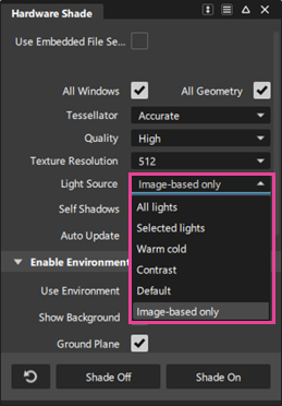

  1. Open Visualization > Hardware Shade.
  2. To interactively create linear reflections, turn on Linear Reflection, select Shade On and close the window.
  3. In the Environment editor, scroll to Linear Reflection Controls.
  4. Adjust the Environment settings to suit your model.

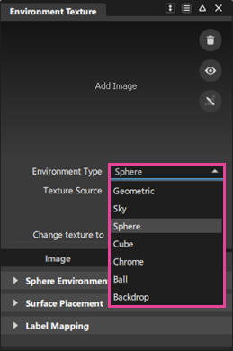

Environment Types and examples
There are several different types of environment textures: ball, chrome, cube, sky, and sphere.

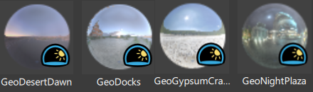

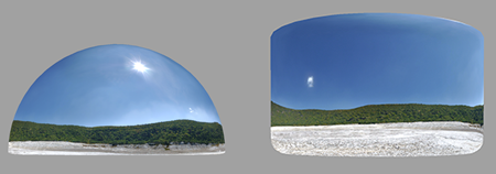

Geometric
Geometric environments create 3D geometry, which is either a dome or cylinder shape. This geometry shape surrounds your model providing a 360 degree scene that maintains a realistic shape to your model regardless of where you view it from.
Geometric environments use HDR images for the image-based lighting and reflections, which are controlled separately from the background.

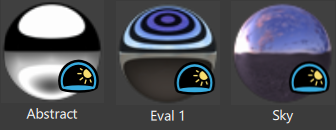

Access these Geometric environments from the Shader Library:
Sky
The Sky texture simulates a planetary environment viewed from the surface of a planet.
Note: If the eye point or view drops below the floor, the Sky texture swatch in the Environment Editor turns red as a warning. Make sure that the eye point is always above the floor (the ground plane).
Sphere
The Sphere environment simulates an environment by mapping a texture or image file directly onto the inner surface of an infinite sphere. The best way to create a sphere environment is to use a ramp texture and paint objects onto it, being sure to avoid the poles and edges.
Access these Sphere type environments from the Shader Library:

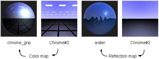

Chrome
The Chrome type simulates a showroom environment. This texture consists of a ground plane and a sky plane (with fluorescent style light rectangles), and provides a simple but effective environment to simulate reflections off chrome surfaces.
Ball
The Ball texture uses an image (or series of images) of a highly reflective chrome ball in an environment (real world or computer generated) to re-create that environment. This is possible because the reflections in the chrome ball provide a (nearly) 360 degree view of the environment.
In order to use the Ball environment texture, you must map the texture’s Image parameter with the image of a reflective chrome ball in the environment you want to re-create. You should also map the Backdrop parameter with the image of the environment without the chrome ball.

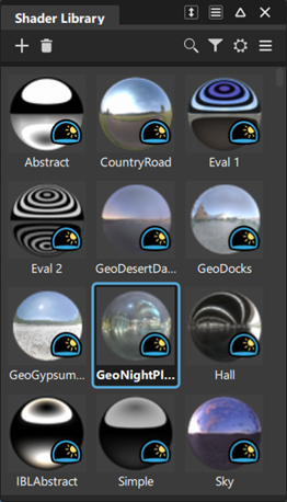

Alias starts with a default environment shader in the scene. It also provides several default environment shaders in the Shader Library. Some of these, such as the geometric environments, have reflection maps and background images.
When working with environment shaders, turn on Use Environment, Show Background, and Ground Plane in Hardware Shade window so that all the environment effects display in your scene.
You can also create your own custom environment shaders. For more information, see Create an environment.

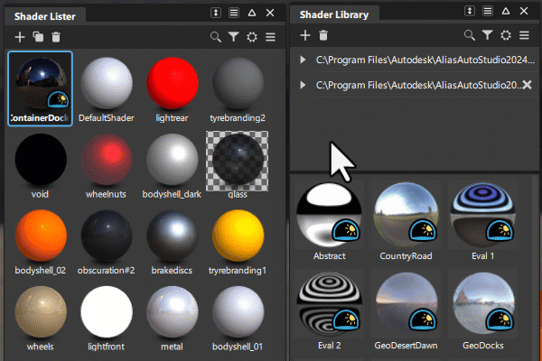

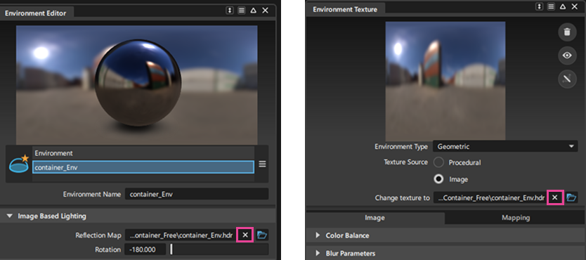

Too add an environment shader from the Shader Library to your scene:
  1. LMB-drag an environment shader from the Shader Library into your scene.
  2. In the Shader Library, double-click the environment shader's swatch to open the Environment Editor.
  3. Adjust the parameters in the Environment Editor to get the desired look.
    For example, if you added a Geometric environment, use the Image Based Lighting parameters such as Rotation and Tone Mapping to adjust the reflections.
For more information on modifying geometric environments, see Create a geometric environment.
You can create multiple customs environments in your scene and switch between them from the list in the editor. You can create a custom environment by creating a new environment shader or by modifying an existing one to include a geometric background and an HDR reflection map.

Create a new geometric environment shader

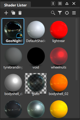

  1. In the Environment Editor, select the More menu, then Create Environment.
  2. When prompted, browse to the location of the .hdr image you want to use for the Reflection Map.
    Note: If you do not want to use a Reflection Map or background image in your environment, remove the image by selecting the X beside the image path and in the Environment Texture Editor.
  3. Adjust the environment attributes to achieve the desired look.
  4. Switch between active environments by selecting them in the list.
Create the geometric background

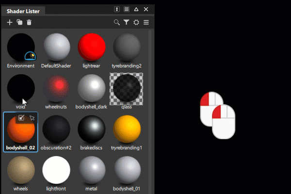

If your environment does not already have a geometric background, you can create one by following these steps:
  1. In the Shader Lister, double-click the default environment shader to open its parameters in the Environment Editor.
    Note: You can also select Edit Environment from the More menu to access the editor.
  2. In the Background section of the Environment Editor, click the texture icon beside Color.
    The Environment Texture Editor opens.
  3. Set the Environment Type to Geometric.
    By default, the Geometry Type is set to Cylinder Geometry. You can also choose Dome geometry by selecting it as the Geometry Type.
  4. For Texture Source, select Image.
  5. Click the file browser icon beside Change texture to, and locate the image you want to use as the geometric background.
    The background image is mapped to either a Dome or a Cylinder (depending on the Geometry Type chosen) that surrounds your model.
  6. Use the Rotate, Scale, and Height parameters to position the image.
Add the Reflection Map
Use an HDR image to generate reflections in the environment. In this example, the reflection map image is an HDR version of the geometric background image.
  1. In the Environment Editor, click the file browser icon beside Reflection Map, and browse to the location of the HDR image you want to use.
  2. Adjust the Rotation and Tone Mapping parameters to modify the effect of the reflections.
Adjust the lighting
In the Hardware Shade window, you can specify the lighting to be Image Based, or use a combination of the HDR image light and the preset lighting.
You can also use the light emitted from your reflection map image by setting the Light Source in the Hardware Shade window to Image-Based Lighting only.
Add the environment to the Shader Library
Add your custom geometric shader so you can use it in other files.
  1. Rename your geometric environment.
  2. MMB-drag the shader into your custom Shader Library.
Add image-based lighting
Instead of mapping an environment texture to the Background color of an environment, you can choose a high dynamic range (HDR) image for image-based lighting.
  1. In the Image Based Lighting section of the Environment Editor, click the folder icon beside Reflection Map.
  2. Browse to the location of the HDR image you want to use.
    Note: Ensure that Use Environment is turned on in the Enable Environment Effects section of the Hardware Shade window.
    After the HDR image loads, you might need adjust the tone of it to get the look you want. HDR images cover a wide range of lighting conditions, so the default selection may not be the look you want.
  3. In the Tone Mapping section of the Environment Editor, use Gamma, Exposure, and Saturation to adjust the color, brightness, and tonal range of the HDR image.
    Note: In the Hardware Shade window you can specify the lighting to be Image Based Only, or use a combination of the HDR image light and the preset lighting (see Hardware Shade settings).
Create a 3D environment
  1. In the Environment Editor, expand Background, and then click the texture icon beside Color.
  2. In the Environment Texture Editor, select an Environment Type.
  3. If the chosen Environment Type needs an image, click Change Texture to and browse to the texture image you want to use.
  4. Customize the environment texture by editing the parameters in the editor.
