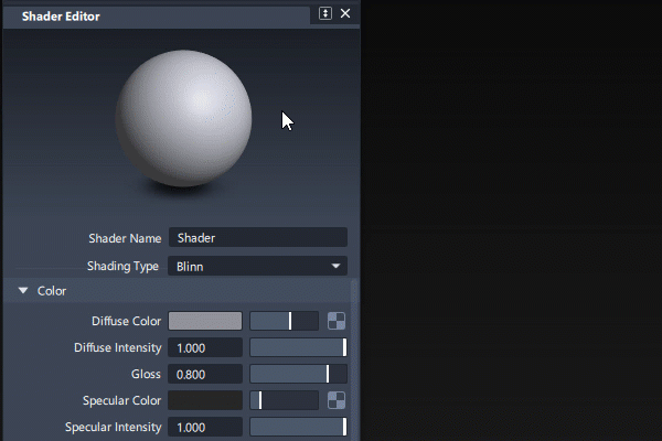

Shader Editor
Opens Shader Editor, which you use to edit shaders parameters and create textures.
A separate Texture Editor window opens when you map shader parameters to procedural or projected images (see Texture Parameters).

Shading Parameters
Color
Diffuse Color
The color of the surface.

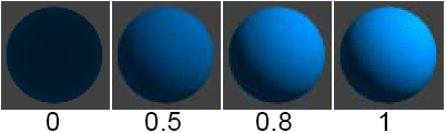

Diffuse Intensity
The ability of the surface to reflect light in all directions. The Diffuse value acts like a scaling factor applied to the Color setting: the higher the Diffuse value, the closer the actual surface color is to the Color setting. The valid range is 0 to infinity. The slider range is 0 (no light is reflected in all directions) to 1. The default color Value is 0.8.
Click this icon to map this parameter to a procedural texture or projected image. See Texture Parameters.

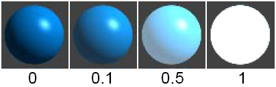

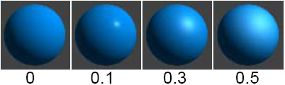

Specular Intensity
Specularity works with Gloss to determine the appearance of specular highlights that are based on the color of the bright parts of the environment cast on the object.
Specular reflections (the blurry ones), which in the past only reflected the light sources, such as point and directional lights, used to be colored only by Specular Color. Now they are colored by a blend of the Specular Color and the (diffuse) Color (which is actually the diffuse color of the surface), with the blending being controlled by Gloss. When Gloss is 1.0, it's pure “Specular Color”, when Gloss is 0.0 it's pure (diffuse) “Color.”
This is handy because it lets you do with one shader something that used to require a layered shader. It's also positively irreplacable with image based lighting (IBL), since even a layered shader wouldn't give you independent control over reflected and specular part of IBL.
Experiment with these two parameters together in Hardware shading to get new effects.
Low gloss and high specularity can produce a satiny, lustrous surface like a pearl or wood with an oiled or waxed finish. High gloss and low specularity gives small precise highlights, like highly polished enamel surfaces or wood with a varathane finish.

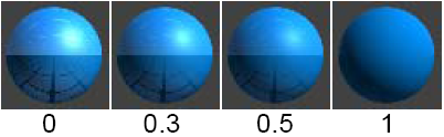

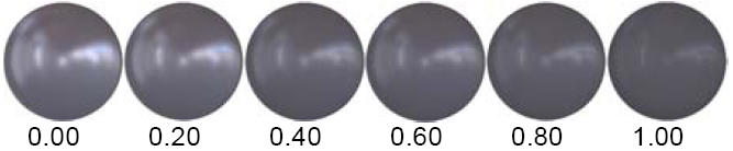

Specular Rolloff
The ability of the surface to reflect its surroundings (the environment, other surfaces), or the Reflection map, if any, when viewed at oblique angles. This parameter appears only when Shading Model is BLINN. To help visualize the effect of Spec. Rolloff in the shader swatch, temporarily assign a Reflection map to the shader.
The slider range is 0 to 1. The default value is 0.3.
Tip: Use a Spec. Rolloff value of 0.7 to simulate a wet surface (for example, wet paint).

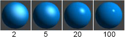

Shinyness
Controls the size of shiny highlights on the surface. This parameter is only available when Shading Model is PHONG. The valid range is 2 to infinity. The slider range is 2 (broad highlight, not very shiny surface) to 100 (small highlight, very shiny surface). The default value is 20.

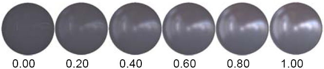

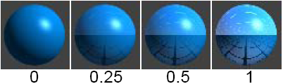

Reflectivity
The ability of the surface to reflect its surroundings (the environment, other surfaces), or the Reflection map, if any. Reflectivity values for common surface materials are: car paint (0.4), glass (0.7), mirror (1), chrome (1). To help visualize the effect of Reflectivity in the shader swatch, temporarily assign a Reflection map to the shader.
The valid range is 0 to infinity. The slider range is 0 (no reflections) to 1 (clear reflections). The default value is 0.5.
Note: Reflections are calculated only during raytracing.

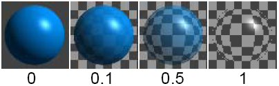

Transparency
The color and level of transparency of a surface. For example, if the Transparency Value is 0 (black), the surface is totally opaque; if the Transparency value is 1 (white), the surface is totally transparent. To make an object transparent, set the Transparency color to a shade of gray or to the same color as the shader Color. The default value is 0 (black).
If you change Transparency from the default black (0), the background of the shader’s Shader Editor swatch becomes a checkered pattern. This is a visual aid and is not rendered in your scene.

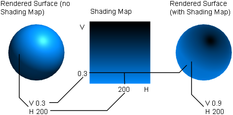

Shading Map
Applies a color map to the surface after it is rendered. The U value of the Shading Map texture is mapped to the surface’s hue, and the V value is mapped to the surface’s intensity (the value defined by [R+G+B]/3). A shading map changes the shader’s color, specular color, and eccentricity, effectively creating a new type of shading model.
A Shading Map is useful for creating non-photorealistic effects (for example, cartoon shading) or for highlighting threshold values (for example, using a ramp texture).

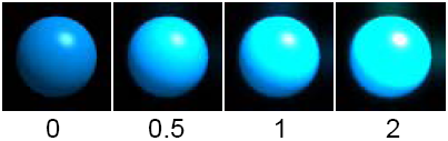

Glow
The Glow parameters define the type of glow produced from light reflecting off a surface, or from surface incandescence.
Glow Intens (Glow Intensity)
The brightness of the shader glow effect. The slider range is 0 to 1. The default value is 0.
Shader glow appears different at different image resolutions. If the Environment’s Glow Type and Halo Type are both off (in the Shader Glow section of the Control Window), the Glow Intens. value has no effect.
