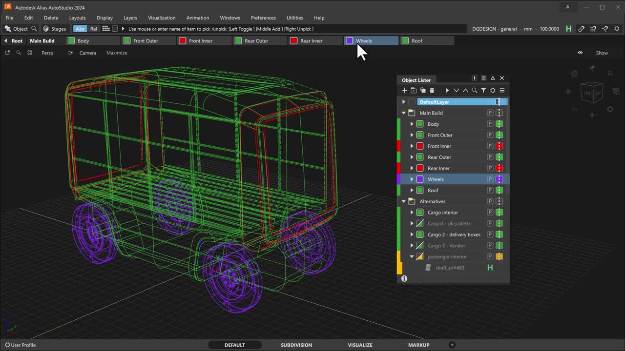

Layer Bar
Shows or hides the Layer Bar in the viewport below the promptline. Use the Layer Bar to access, create, and manage your layers, as well as complete other layer-based tasks like you would with the Object Lister.

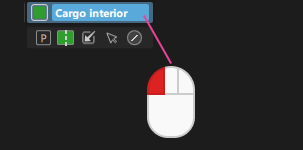

Use LMB on a layer or layer folder to display options for quickly picking objects and assigning them to layers as well as toggling symmetry on and off.

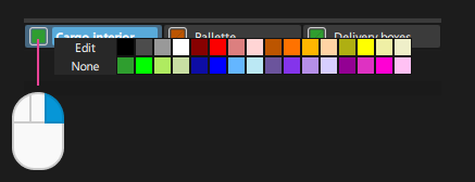

Use RMB on the visibility box to select a color for the items in the scene that are assigned to that layer.

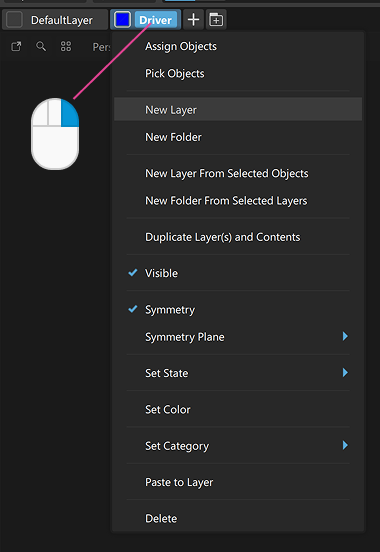

Use RMB on the layer number or layer name to access the full menu of layer options.

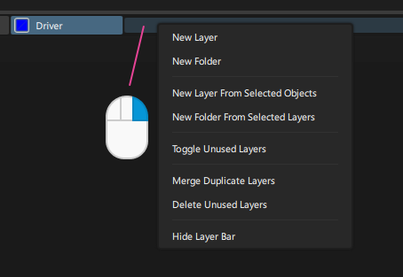

Use RMB on the empty space beside the layer name to access a condensed menu.
