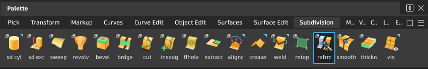

Access the tool from the Subdivision Palette:

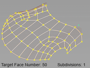

Target Face Number
Sets the number of subdivision faces generated in the output object. The higher the value, the higher the resolution of the subdivision model. This value is an approximate target value. For example, a value of 50 results in a subdivision object with between 40 and 60 quad faces.

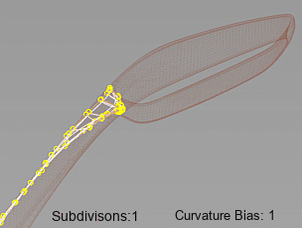

Curvature Bias
Use this setting to increase the distribution of CVs to areas of higher curvature, which can improve the overall shape of the resulting subdivision model. At lower values, the resulting CV layout is more uniform. Increasing this value changes the layout CV to one that distributes a higher number of CVs to areas with more curvature. Typically, higher values take longer to compute.

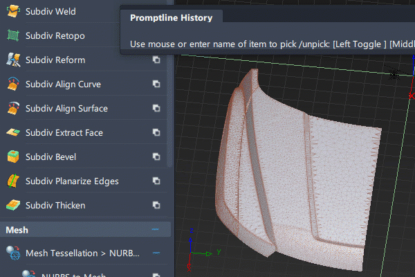

Reform tool workflow
Shift-select the tool to open the control window.
Tip: Use the tool's default values to generate the first version of the subdivision object, and then adjust the Refinement parameter values until you achieve the desired results. If you don't achieve acceptable results, adjust Target Face Number.Select the source mesh, and then click Build or press the Spacebar.
In the control window, adjust a tool parameter and click Update or press the Spacebar to rebuild the subdivision model.
To further refine the model, such as by adding or removing edges, click Edit in Retopo.
The Retopo tool opens and the mesh is selected as the target object so you can begin editing right away.
