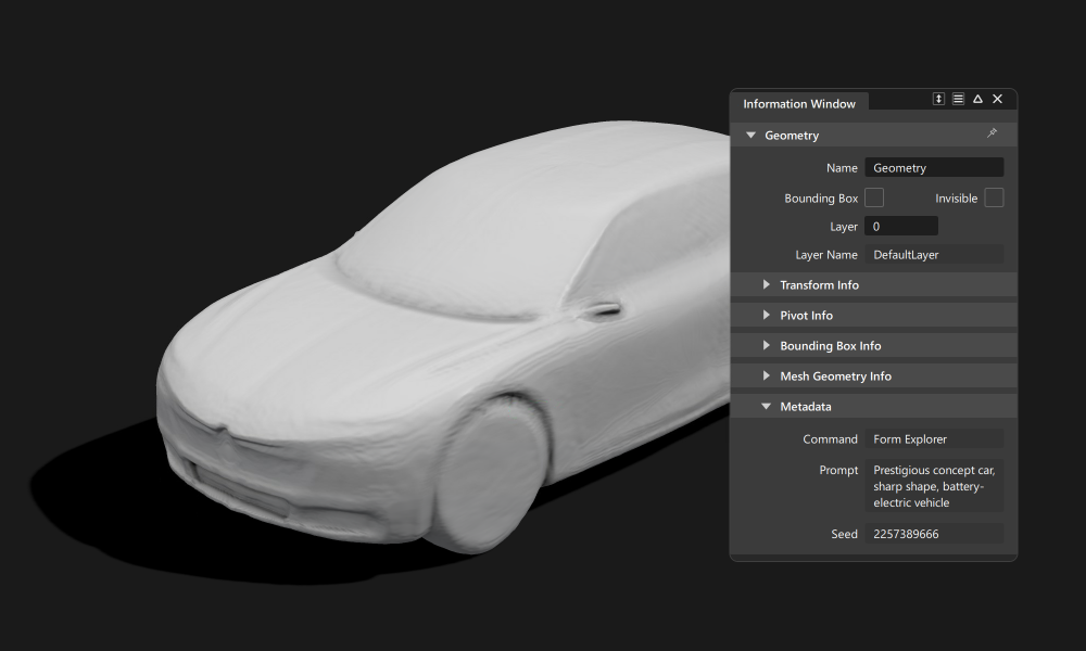

  • Prompts, seed and settings are attached as metadata to the generated mesh geometry object. You can view them in the Information Window.
A mesh of a car in the viewport and the Information Window with metadata showing Command, Prompt and Seed.
