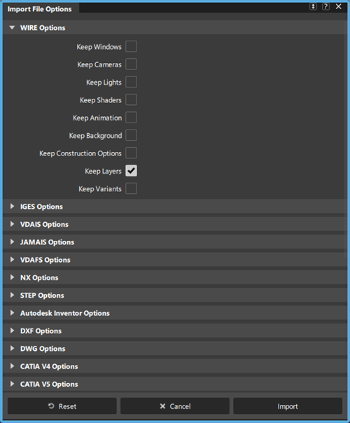

WIRE Options
Programmers can access wire files via the Alias OpenModel library.
From within Alias you can open an older wire version. Rename older wire files to keep the older file format version and begin working in the latest version of Alias. Supported entities include surfaces, curves, and polygon sets.
Keep Windows
Imports windows.
Keep Cameras
Imports cameras.
Keep Lights
Imports lights.

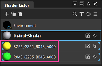

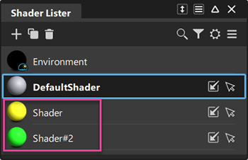

Keep Shaders
Imports shaders.
Replace Shaders by Name
When importing shaders (Keep Shaders turned on), you can choose to replace the incoming shaders with shaders in the currently set User Library location. Replace Shader by Name only works with shaders that have the same name.
This option is not visible if Keep Shaders is turned off.
Note: By default, when you import objects, any incoming shaders having the same names as an existing shader get renamed by appending a # suffix to its name. This avoids name clashes between shaders. You can instead merge incoming shaders with existing shaders that have the same base-name by turning on Ignore # suffixes and merge.
For more information, see the Replace shaders by name.
Keep Animation
Imports animation. Determines whether to retrieve animations or only models. The default is ON.
When selected, both models and animation are retrieved. A window that contains an animated camera is retrieved with the model.
When not selected, only models are retrieved.
Keep Background
Imports backgrounds contained in a wire file.
Keep Construction Options
Prompts you to Accept the construction options contained in the wire file.
Keep Render Globals
Imports the render globals set for the wire file into the system, overriding the current settings.
To set render globals, use Render > Globals.
Keep Layers
Imports the layers you set in the wire file.
Keep Variants
Imports variants.

Material Naming Scheme - (Applies to Fill Colors to HW Shaders) Defines how the resulting shaders are named.
When set to By RGBA Values, the imported shaders are named using their RGB color values.
When set to None, imported shaders are named sequentially as "Shader".

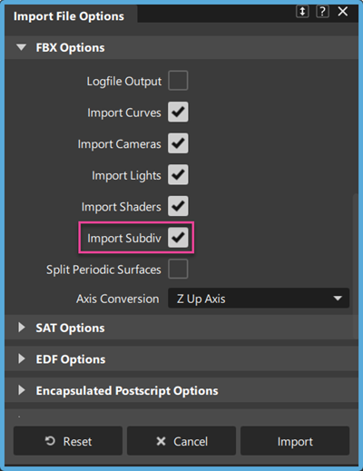

Import Subdiv
Imports subdivision objects
Note: To ensure that creases are preserved in the .fbx file, turn on Smooth Mesh in the Maya FBX Export options before exporting data from Maya (see Export polygon objects to .fbx files).

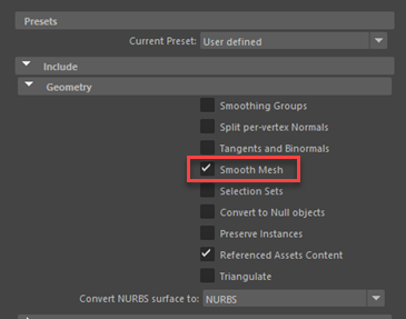

  • To display G0 creases added by the Alias Subdivision Crease Edge tool, turn on Smooth Mesh Preview after loading the file in Maya.
  • To preserve creases in Maya polygon objects in Alias, turn on Smooth Mesh in the Maya FBX Export options before exporting geometry from Maya.

  3. In the Export Options, under General Options, select FBX export from the File type list.
  4. To ensure that the creases in your object are preserved in the exported file, Smooth Mesh must turned on before exporting. To do this:
    • Click Edit preset.
    • In the Edit export preset window, click Geometry and ensure that Smooth Mesh is turned on.
    • Click Close.

Import the .fbx object into Alias
  1. In Alias, choose File > Import > File > .
  2. In the Import File Options window, select FBX Options from the list.
    Ensure that Import Subdiv is turned on.
    Note: Since Alias has the Z axis (not the Y axis like Maya) pointing up by default, the model will appear rotated on its side in Alias. You can change this by setting the Axis Conversion to Z Up Axis in the Import Options. For more information, see FBX import options.
  3. Click Import.
When importing shaders, you can choose to replace the incoming shaders with shaders in the currently set User Library location. Replace Shader by Name only works with shaders that have the same name.
Ignore # Suffixes
Turn this on to merge incoming shaders with existing shaders that have the same base-name.
