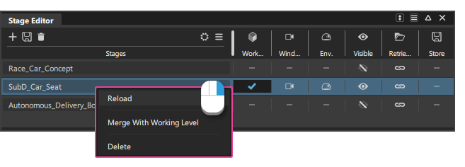

Delete Selected Stage - Select a stage by clicking on the name to highlight the row with a blue background. Alternatively use the context menu Delete command (RMB).
Delete All Stages - Deletes all stages, leaving a default, empty stage only.
Note: deleting stages does not save any changes that have been made to the geometry. Make sure you save any required changes before using the delete stages tools.

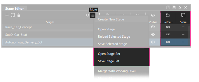

- More - The More menu has duplicates of the icon bar and context menu tools plus one unique tool:
- Merge All - Merges all the stages in the Stage Editor into the Working Level stage.

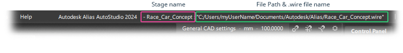

Name
Displays the stage name or the .wire file name (and path).
Choose the display type (Stage name or File path) in the Settings menu
.When a .wire file is opened, the stage name defaults to the same name as the .wire file (possibly with a suffix if the file has been previously opened).

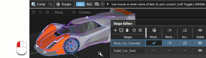

Working Level
Sets which stage is active:
Only one stage at a time can be the Working Stage where geometry can be created, selected, and modified.
Objects on inactive stages display in pale green (if visibility is on for that stage).
If you are in the middle of geometry operations, such as building a curve or selecting curves for a rail surface, switching the Working Level stage will restart the tool.

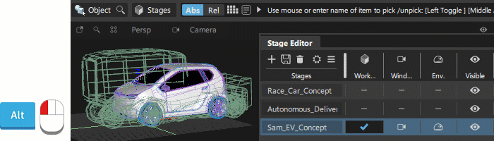

Using
Alt+ LMB to select the Working Level switches all settings to the working level stage, including the Window Source.

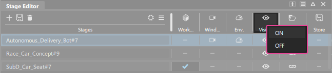

Visible
Sets which stages are visible in the scene.
All stages can be invisible except for the Working Level.
When a stage is not set as the Working Level stage but set to visible, the geometry displays as pale green wireframe.
Using
Alt+ LMB to select the Working Level turns visibility off for all stages except the Working Level stage.The icon at the top can be used as a menu to turn all stages visible or invisible (excluding the Working Level stage).

Typically the Stage name is the same as the .wire file name, and both are displayed on the application header bar:

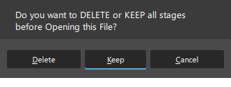

Multiple stages are typically created during the File > Open process when responding to the File > Open dialog box:
Choosing Delete when using File > Open ensures that you open just one model at a time. There will still be a Stage associated with the opened .wire file, but it is simply a technical requirement and has no use for the user.
Choosing Keep when using File > Open keeps the previous .wire file(s) and adds the new file as an additional stage listed in the Stage Editor. The newly opened file is set as the Working Stage.

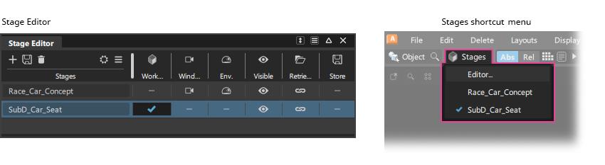

Stages shortcut menu
The Stages shortcut menu is on the promptline and can be used to:
- Open the Stage Editor.
- Switch the Working Level to a stage in the list using the LMB.
- Exclusively switch all settings to a stage in the list using
Alt+ LMB.

In a busy design studio, you may be working on different, unrelated projects throughout the day. Using stages means you can keep more than one model open at a time and quickly switch between them.
In this workflow you will typically switch all settings so that the each model is viewed as if it was the only file open.
Use Alt + LMB (Switch Stage Exclusive) on the Working Level checkmark or stage name in the editor to:
- Set the Working Level to the selected stage and make it visible.
- Turn Visibility off for all other stages.
- Set the Window Source and Environment Source to the selected stage.
The Alt + LMB exclusive switch can also be used on the Stages shortcut menu.
Workflow 2 - Working on related components of a project
All stages share the same world axes, so the Working Level stage can be viewed in context, with other inactive stages displayed in pale green. It can also be useful to maintain a consistent viewpoint and view windows when changing the Working Level to work on a different component.
The typical workflow would be to only change the working level and leave all stages visible. The Window Source and Environment Source are typically unchanged, but they can be set in the Stage Editor if required.
To only switch the Working Level:
In the Stage Editor select the Working level check mark.
In the Stages shortcut menu use LMB only to select the stage from the list.

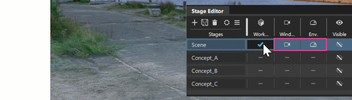

Workflow 3 - Using a Stage for visualizing alternative models
When shading a model, one technique is to create a stage environment. Each model (in separate stages) is then visualized using the same view, lighting, and environment. In this case, keep the Window Source (and the Environment Source) set to the scene stage, and only switch the Working Level between the different model stages.
To make changes to the environment shader, set the Working Level to the stage with Environment Source selected.

Workflow - Working with Stage Sets (Advanced)
There are two tools for working with Stage Sets:
File > Save Stage Set - Saves a text file with a .stg suffix, which lists the stages and settings in the Stage Editor.
File > Open Stage Set - Re-opens the list of .wire files in one operation.
A Stage Set is a saved text file with a .stg suffix and lists the stages and their settings in the Stage Editor. This can be used to re-open the same set of .wire files in one operation using File > Open Stage Set.
These tools are also available in the Stage Editor along with the Auto Retrieve and Wire Store settings that apply when stages are saved:
When you save a Stage Set, the Wire Store column settings apply:
Wire Store off (default) - The .wire file is not saved when the Stage Set is saved (only the list of stages in the set is saved).
In this case, you are responsible for choosing whether or not to save any changes to your model by setting the stage to the Working LOevel and using File > Save or Save As. In this case, Save Stage Set is only saving the list of stage. The .wire files and any changes made to the geometry are not saved.
Wire Store on - The .wire file is saved when the Stage Set is saved.
tool in the main menu has the option of prompting the user to choose whether to save each .wire file. This can be useful when using the default setting of Wire Store off as it prompts you to make decisions on saving each of the loaded .wire files.
