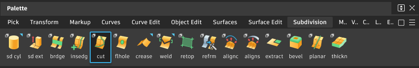

Access the tool from the Subdivision Palette:
