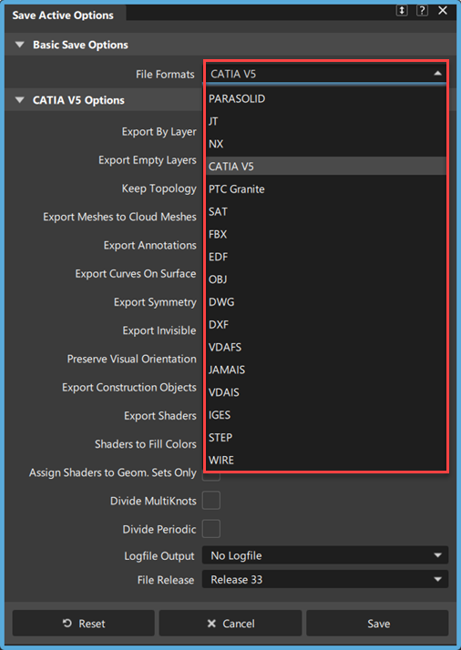

Export Active As
Lets you to translate Alias data into appropriate CAD file formats.
To save the entire scene (not just the picked objects), use File > Save or File > Save As.
The window displays different options based on the file format you choose. Some file formats, such as OpenInventor, have no options.
Note: An intermediate file gets generated during file translations of all supported formats. The intermediate file has a Translating_source file name prefix and appears in a temporary directory until the translation operation completes.

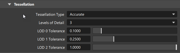

Tessellation Options
Tessellation Type
You can choose between three different tessellators:
  • Fast – Uses the same tessellator as Hardware Shade with the Fast option selected. This is the default. Command-line equivalent: -to.
  • Accurate – Uses the same tessellator as Hardware Shade with the Accurate option selected. Command-line equivalent: -ta. (This replaces the old AG tessellator.)
  • Use extisting tessellation – This should give you the same tessellation as in Hardware Shade when Show Triangles is on (this option appears when Quality is set to User defined). Command-line equivalent: -td.
Levels of Detail
This option applies to Fast and Accurate tessellation modes only. It indicates the number of tessellations that will be saved in the JT file (1, 2, or 3). The default is 1.
LOD 0 tol
Use this slider to set the tessellation tolerance for the first tessellation. The default is 1.0
LOD 1 tol
This slider only appears if Levels of Detail is set to 2 or 3. Use it to set the tessellation tolerance for the second tessellation. The default is 2.5.
LOD 2 tol
This slider only appears if Levels of Detail is set to 3. Use it to set the tessellation tolerance for the third tessellation. The default is 10.0.

CATIA V5 options
Export By Layer
Convert layers to open body/geometrical sets (-a option specified for AlToC5). The default is on.
Note: The entire Alias layer hierarchy is preserved in the translated CATIA file, including layer folders. This lets you import the file back to Alias, using Convert Geometric Sets to Layers, and have the file's original layer hierarchy maintained.
Export Empty Layers
The default is on.
Keep Topology
When this option is ON (default), Alias shells are converted to CATIA skins. When it is OFF (-s option specified for AlToC5), Alias shells are converted to CATIA Faces.
Export Meshes to Cloud Meshes
The default is on.

About exporting CATIA V5 files
Before you create the model:
  • Set units to mm.
  • Set optimal tolerances in accordance with CATIA V5. The default tolerances are:
    Curve Fit Distance = 0.001 mm Curve Fit Checkpoints = 10 Max Gap Distance = 0.001 mm Trim Curve Fit = 0.005 mm Topology Distance = 0.02 mm

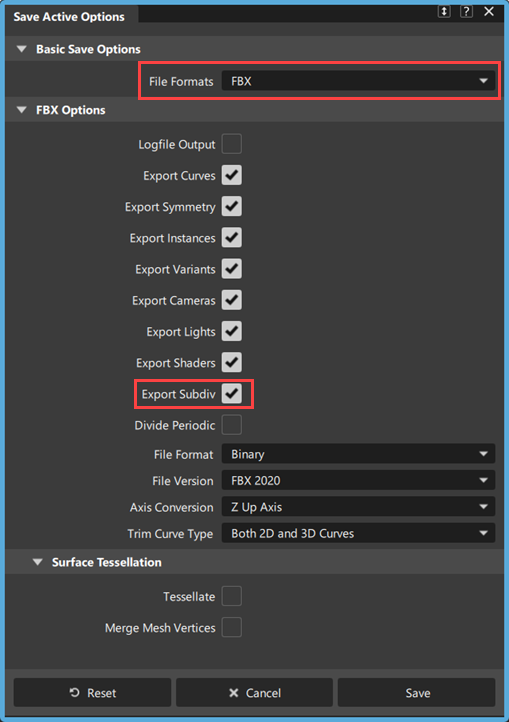

FBX options
Logfile Output
Generates a log file containing a list of path names of exported files, a list of warning and/or error messages, and the options string.
Export Curves
Exports 3D curves.
Export Symmetry
This option applies to layers that have mirror symmetry turned on in Alias. When selected, this option exports the mirrored instance of the geometry.
Export Instances
Exports instanced geometry.
Export Bookmarks
Exports Alias bookmarks and maps them to FBX cameras.
Export Cameras
Exports Alias cameras.
Export Lights
Exports Alias lights to FBX.
Export Shaders
Exports Alias materials to FBX.
Export Subdiv
Exports subdivision objects. Subdivision creases and material assignments are supported.
Divide Periodic
Divides (splits) a periodic surface into multiple surfaces.

Trim Curve Type
Exports either 2D Parameter Space Curves, 3D Model Space Curves, or Both 2D and 3D Curves.
Surface Tessellation
Geometry Type
Lets you choose to only export the mesh or NURBS data to a file or export both types together in the same file.
  • NURBS - Exports NURBS data only.
  • Tessellation - Exports tessellated mesh data only.
  • Both NURBS and Tessellation Exports mesh and NURBS data.
Tolerance
Specifies the amount the polygonal surface can deviate from the original NURBS surface. The default value is 0.01. This option does not apply when Geometry Type is set to NURBS.
Tessellator
Choose between two different tessellators. This option does not apply when Geometry Type is set to NURBS.
  • Fast - Uses the same tessellator as Hardware Shade with the Fast option selected. This is the default.
  • Accurate - Uses the same tessellator as Hardware Shade with the Accurate option selected.
Merge Mesh Vertices
Merges the tessellated output into a single mesh object. This makes the FBX file better suited for import into other applications such as Autodesk Maya.

Export subdivision objects to a .fbx file
  1. In Alias, select the subdivision objects you want to transfer.
    If you select multiple subdivision objects, they are combined as a single mesh object when imported into Maya.
  2. Choose File > Export > Active As > .
  3. In the Save Active Options window, select FBX from the File Formats list.
  4. Under the FBX Options, ensure the Export Subdiv is turned on, and then click Save.
  5. Name your FBX file and click Save.

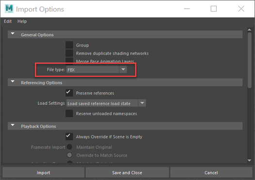

Import the .fbx file into Maya
  1. In Maya, choose File > Import > .
  2. In the Import Options, under General Options, select FBX from the File type list.
  3. Click Import, browse to your .fbx file, and then cick Import.
You can now edit the Alias subdivision object as a polygon mesh in Maya.

IGES options
IGES (Initial Graphics Exchange Specification) is a data exchange format between CAD/CAM systems.
Curves and surfaces are written to IGES as NURBS curves and surfaces. Layer Number information is exported as IGES Level information and can be recognized by each IGES entity. Alias Set information is not exported.
When storing an IGES file, the following options are available:
