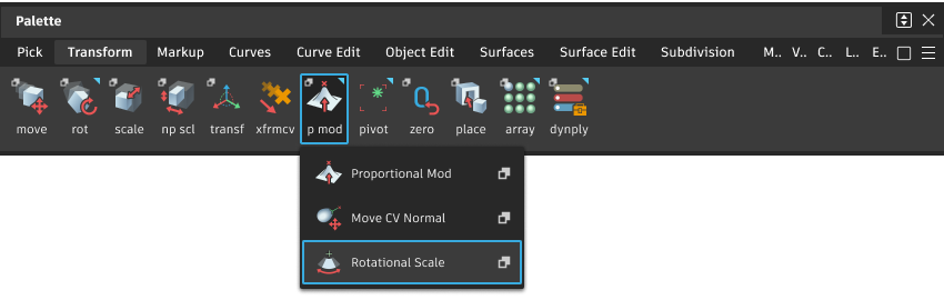

Access this tool from the Transform tool palette:

  1. Select the Rotational Scale tool .

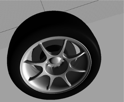

Rotational scale example

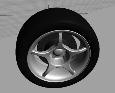

To create an eight-spoked wheel by rotationally scaling a spoke of a five-spoked wheel:
  1. Select the geometry for one of the spokes, and toggle the rest of the model invisible or templated, or delete it. (You can use intersecting planes to "slice" out a section of the wheel.)
  2. Shift-select the Rotational Scale tool icon.
  3. In the option box, set the input mode to Number of divisions.
  4. Place the pivot point at the center of the wheel and the second point along the spoke to set the axis of rotation.
  5. Now enter how many divisions were in the original model. (Type 5 for this example.)
  6. Enter the new number of divisions. (For this example, type in 8.) The element is scaled to its new angle.
  7. You are now finished deforming the model. To complete the new wheel, create seven additional copies of this spoke, each rotated by the correct amount.
    To make these copies, use Edit > Duplicate > Object. In this example, the wheel was in the X - Z plane, so the rotation is about the Y axis. Set the following options in the Duplicate Object Options window:
    • Rotation – Y 45
    • Number of duplicates – 7
    • Geometry type – instance
    A new wheel is created, with eight spokes:
