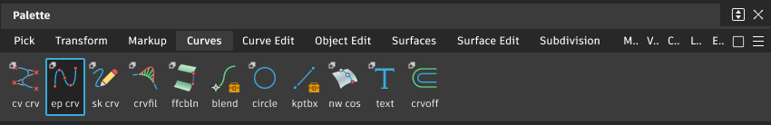

Creates new NURBS curves in the scene by placing edit points.
Access this tool from the Curves tool palette:
