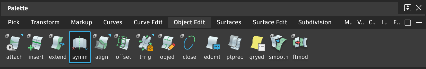

Access this tool from the Object Edit tool palette:

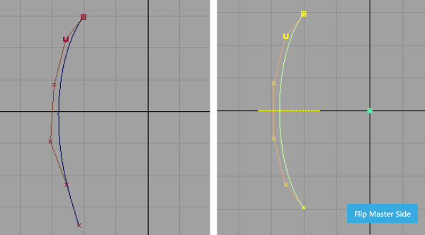

    If the curve is not already symmetric, the tool modifies the controls to make it symmetric. The position of the controls from the beginning of the curve are applied to the symmetric partners at the end of the curve. Click the Flip Master Side button to have it work the other way around.

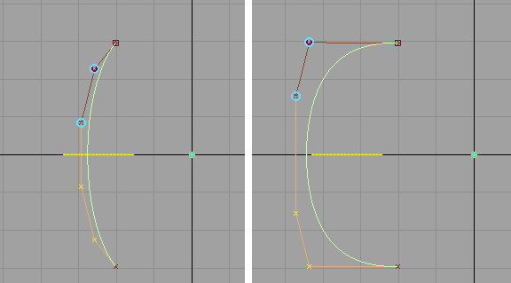

  3. Pick one or more CVs on one side of the curve.
    Blue circles appear around the corresponding CVs on the symmetric half.
  4. Move the CVs. You can use any transformation tool, such as Transform > Move or Control Panel > Transform CV.
    • The selected CVs follow the mouse. The symmetric CVs move in the opposite direction on the symmetric side of the plane.

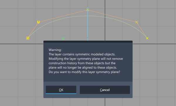

    • If you move the curve, the symmetry plane moves with it but is drawn in a different color to differentiate the curve from symmetric objects still aligned to the layer symmetry plane. A confirm box warns you. Clicking Cancel undoes the transformation.

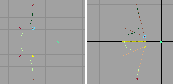

Moving the bottom CV automatically moves its symmetric twin (blue circle) in the opposite direction to maintain the symmetry.
After the curve or surface has been made symmetric, any transformation tool can be applied to the controls.

  • If the input curve or surface is not symmetric, the tool modifies the controls of the model to ensure that it is symmetric. It applies the position of the controls from the beginning of the curve or surface to the symmetric partners at the end of the curve or surface. Click the Flip Master Side button to have it work the other way around.
    Note: If the curve or surface was already symmetric, the Flip Master Side button does not appear.
  • If a control (CV, edit point, or blend point) is selected prior to entering the Symmetric Modeling tool, the side of the object containing the picked control becomes the master side and is not modified when the object is made symmetric.

  • The symmetry plane for a layer can be modified through Layers > Symmetry Plane > Set Plane. This does not affect the symmetry plane assigned to any curve or surface through the Symmetric Modeling tool.
  • Once defined, the symmetry plane is unique to each curve or surface. When a curve or surface is transformed, its symmetry plane becomes decoupled from the layer symmetry plane, and follows the object. If the plane doesn’t match the layer symmetry plane anymore, it is drawn in a different color. A confirm box also appears in this case.
