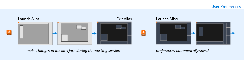

User Preferences
Alias automatically stores all the changes that you make to the user interface in the User Preferences. This means that when you close Alias, the next time you start it the interface will be exactly as you left it.
The exception to this are the settings values in each tool window which are reset between Alias sessions, so that Alias always starts with predictable default settings.
All the elements of the interface are saved, including:
- Which Editors and Toolboxes are open, their settings, location and docked status.

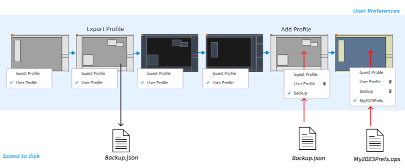

Exporting profiles to a backup file
Exporting the user preferences creates a named .json file that can be used as a backup Profile, or for transferring a Profile to another Alias installation.

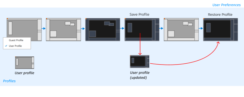

Workflow - Saving interface preferences to a Profile
A profile called 'User Profile' is supplied on launch for you to optionally save versions of your user preferences.
To save the user preferences to the User Profile:

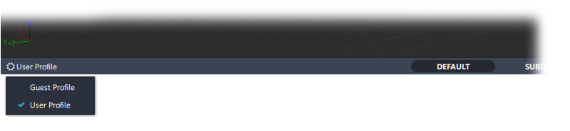

- Check that 'User Profile' is the active profile - shown with a blue checkmark in the Profile list in the Preferences menu or the quick access bar at the bottom-left of the screen.
- Make any interface changes that you want, for example adding tools to shelves or marking menus, setting hotkeys etc., until you have version of your preferences you want to capture.
- Use Save Profile to store these user preferences to the User Profile.
As you continue to work in Alias you will make work-in-progress changes to the interface. You then have two choices:
- To go back to your saved version of the interface by using Restore Profile, and lose any work-in-progress changes you made.
- Update the saved profile to the include the work-in-progress changes by using Save Profile.

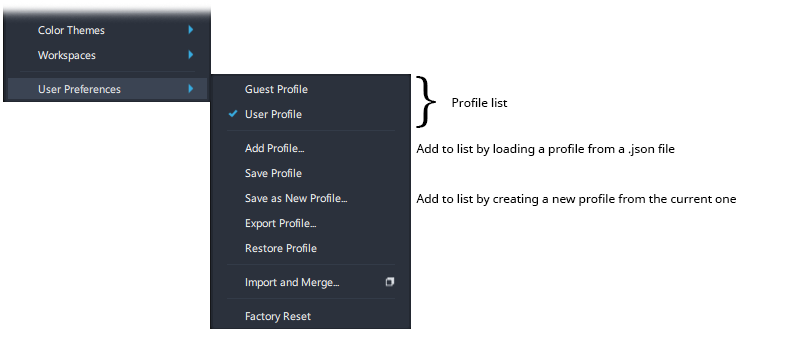

Using additional or alternative Profiles

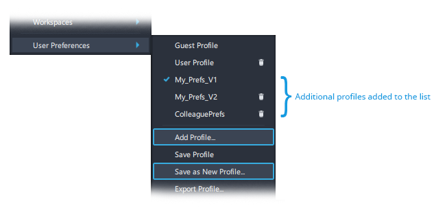

Additional profiles can be created and added to the Profiles list. Additional profiles can be created in two ways:
- Use Save As New Profile to copy the active profile to a new named profile, and switch it to being the current Profile.
- Use Add Profile to import a saved (Exported) Profile file. The profile is only added to list and not made active automatically.

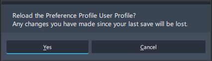

When you switch to a different profile, you need to make a decision about the profile you are replacing:
- If you have done a Save Profile then there will be no difference between your User Preferences on screen and the saved Profile, and so nothing will be lost when you switch.

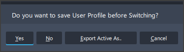

- If you have made changes to the interface since the last Save Profile, then you will be asked if you want to save those changes to the Profile before switching, or discard them.
Before a switch is made a warning message will appear about the current profile being replaced:
- Yes to update the profile before switching. This is the same function as Save Profile.
- No to discard any changes to the current user profile since the last time Save Profile was used for that profile.
- Export Active As to create a backup copy of the current User Preferences on screen to a named .json file. Note, this file will save the current User Preferences on screen and not the saved Profile version of the User Preferences.
- Cancel to not switch profiles.
Workflow - Importing Preferences from a previous version
When importing Preference Sets (.aps files) from Alias version 2023 or earlier, nearly all of your custom UI settings can be transferred to Alias 2024. Some minor edits may be required, such as setting up some custom UI colors, to completely match your Alias 2024 preferences with previous versions.
Export from previous versions
In Alias 2023 or earlier, use Preferences > User Preferences > Export Preference Set and save to a named .aps file.
Import and Merge to Alias 2024 or later

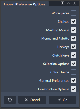

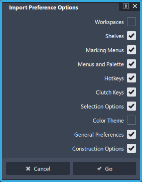

In Alias 2024, select Preferences > User Preferences > Import and Merge >
.In the Import Preferences Options window, ensure only the preferences you want to import are selected.
Tip: To keep the new Alias 2024 Control Panel, Panel shelf and Diagnostic Shade docked group, and the four new Workspaces, don't select Workspaces in the Import and Merge options.
Because the import will modify elements of your current screen, you are prompted whether you want to save your current arrangement to the active Profile before the changes are made:
In the file lister, browse to the .aps preference set file and click OK. The Preference Set gets converted to Alias 2024 format and updates your current User Preferences.
Make any further modifications to the interface that are required, and then use Save Profile or Save As New Profile. Optionally, use Export Profile to make a backup on disk.

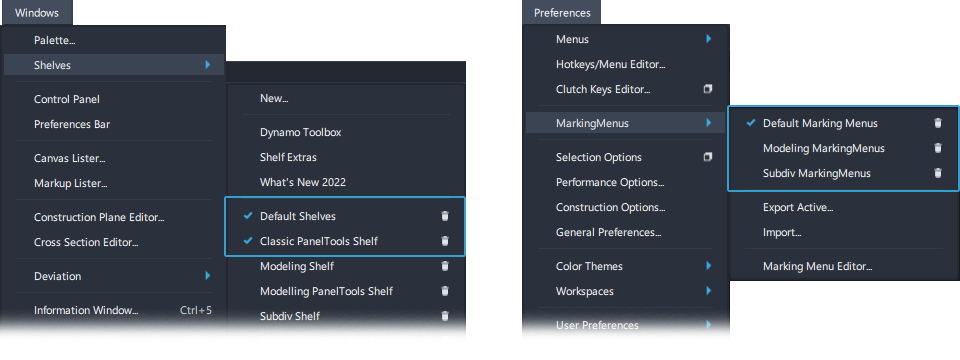

When the Preference Set elements have been imported, they will not appear on screen. Open, position and dock them as required:
The main shelf used in previous versions is loaded into the Windows > Shelves > Default Shelves.
The Control Panel shelves are available loaded into Windows > Shelves .
Marking menu sets are loaded into Preferences > Marking Menus.
