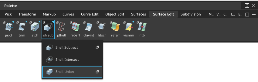

Shell Union
Combines the volumes of two shells into one new shell.
Access this tool from the Surface Edit tool palette :
