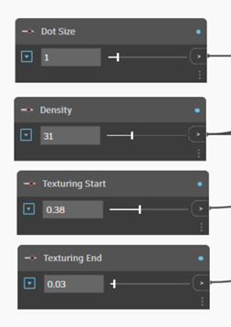

    The sample files include sliders that you can use to explore different values. For example, the 02_Wheel_Texure.dyn file associated with the Wheel_With_History.wire file includes the following sliders.
  4. Drag the sliders to change the values and update the wire file.

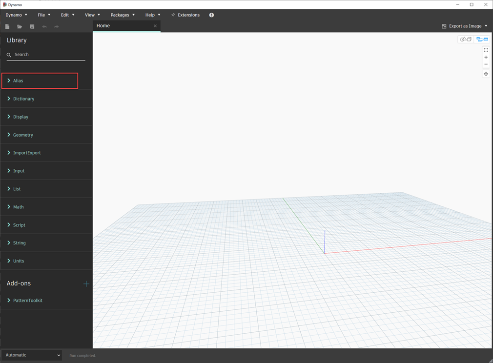

  3. In the Dynamo start panel, under Files, choose New to create a new script, or Open to open an existing script.
    The Alias category appears in the Library. It contains the nodes needed for the Alias-Dynamo workflow.
    For more information, see Alias-Dynamo nodes.

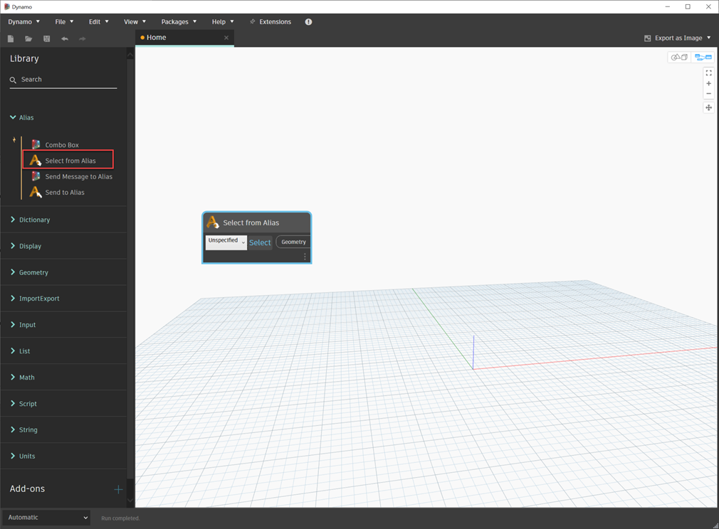

  4. Expand the Alias category and click Select from Alias in the Library to create the Select from Alias node.
  5. Select the type of geometry you want to use as an input for the node.
  1. On the node, click Unspecified and select the input geometry type from the drop-down list. Choose Unspecified if you do not want to predefine a geometry type.
    Note: When you predefine the geometry inputs, Dynamo Player automatically activates the selection filters for each input. This can simplify the process of setting up and running the script for Dynamo Player users.

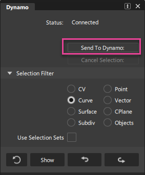

    The focus switches from Dynamo back to Alias.

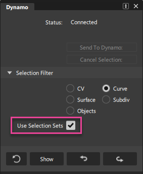

  2. In Alias, select the geometry you want to operate on. If the geometry you want to use is part of a selection set, turn on Use Selection Sets.
  3. In the Dynamo option box, click Send to send the selection to Dynamo.
    In Dynamo, the Select from Alias node shows that elements have been selected.
    • To list the selected geometry, click Geometry.
    • To change the selection, click Change, select the geometry in Alias, then Send to Dynamo.
