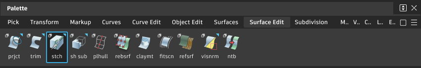

Access this tool from the Surface Edit tool palette:
- Right-clicking Surface Edit and selecting Stitch > Shell Stitch.
