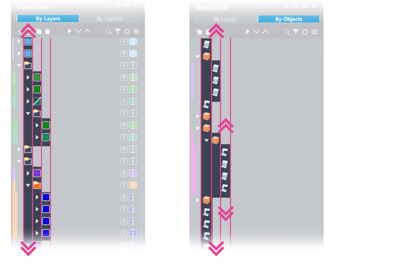

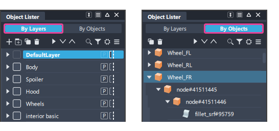

Show by Layers mode lists the layers vertically and can be used either instead of or with the Layer Bar. Objects can also be viewed under each layer.
Show by Objects mode lists all items in the scene and is an alternative or additional tool to the SBD Window for viewing and managing objects.

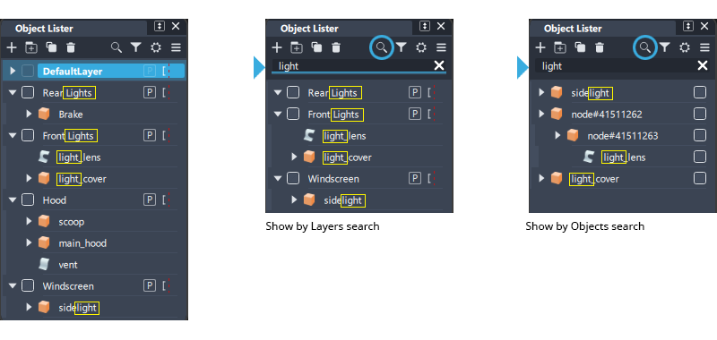

Search - Use keywords to search for layer folders, layers, or objects contained in the scene.

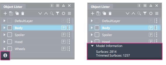

Model Information
Click on the symbol at the bottom of the Object Lister to see statistics for the whole scene:

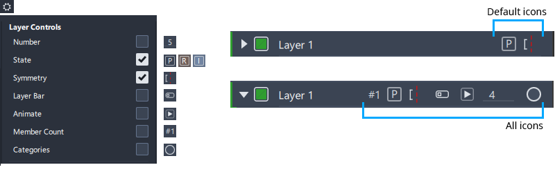

Settings
The Settings menu determines which shortcut or information icons are displayed for each layer or object:
Layer Controls
When Show by Layers is active, choose which icons you want to display in the Object Lister for each layer.

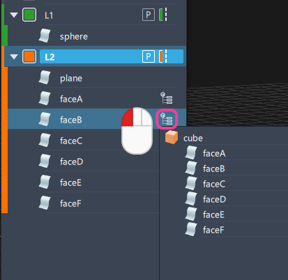

Although Group Membership is in the Object Control list, it is seen when the layer is opened to display the nodes assigned in object mode. The LMB can be used on the group icon displayed to show the full grouped object and its components. You can also select any items from this pop-up window.

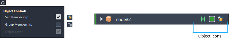

Object Controls
When Show by Objects is active, only set membership and object layer are available:

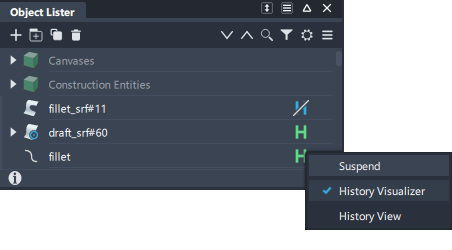

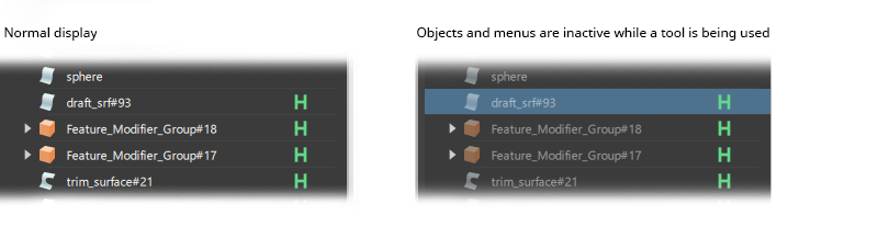

Note: The history icon is used to display whether an object has history, but does not have the option to be turned on or off.
When Object Layer is selected for display, the LMB can be used on the layer square icon to show the layer and its content. You can also select any items from this pop-up window.

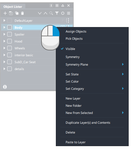

Object Lister context-menus - Show by Layers mode
Use the Right mouse button on a layer to open the menu. The layer you are on becomes selected when the menu is accessed.
These menu options are also available from the Layer menu and the More menu, but in some cases are in a different order to improve access to the most used tools in-context.
Assign Objects
Assigns the selected object or object components to the current layer.
Pick Objects
Picks objects contained in selected layers.
New Layer
Creates a new layer below the layer that is selected with the RMB to open the menu.
If the RMB is used on a folder, the new layer is created within the folder selected.
New Folder
Creates a new empty folder below the layer or folder that is selected with the RMB to open the menu.
If the RMB is used on a folder, the new folder is created within the folder selected.
New Layer from Selected Objects
First select objects in the scene or in the Object Lister, and then use this tool to create a new layer with those objects automatically assigned.
New Folder from Selected Layers
First select layers in the Object Lister, and then use this tool to create a new folder containing those layers.
Duplicate Layer(s) and Contents
Creates a duplicated layer with an incremented name below the one selected. The new layer has duplicates of all the objects in the original layer.
Visible
Makes picked objects visible or invisible. When visible objects are picked, right-clicking shows the check mark turned on. After turning the check mark off, these objects become invisible in the viewport and are grayed out in the Object Lister.
Symmetry
Toggles the automatic display of symmetrical halves of objects on the layer on and off.
Symmetry Plane
  • Set Symmetry Plane - Lets you set the plane across which the automatic symmetrical halves of objects on the layer will be displayed.
  • Symmetry to Geometry - Creates real objects from the automatically displayed symmetrical halves.
Set State
  • Pickable - Makes the selected layers normal and pickable. Pickable objects are indicated by this icon:
  • Reference - Sets the layers to be visible but not pickable. Use this setting to snap to objects without picking them. These objects are indicated by this icon:
  • Inactive - Sets the selected layers to be templated and inactive. Like objects templated with Display > Template. The objects are visible but not snappable or pickable. Inactive objects are indicated by this icon: .
Set Color
Opens a color palette to assign a color to the selected layer or folder. The color assigned here is used for all objects assigned to the layer unless they have their own color assigned individually. Click Edit to open the Color Editor to set a custom color.
Set Categories
Opens the Categories Lister.
Paste to Layer
First select objects in the scene or in the Object Lister, and then use Edit > Copy. Then, RMB click on your required layer and choose Paste to Layer to put the objects directly onto that layer.
This is the equivalent of using Edit > Paste followed by Assign Objects, so this saves one step.
Delete
Deletes the selected layer or folder. If the layer or folder contains objects, a confirmation dialog appears asking whether you want to delete the contents as well.
Delete Layers/Folders and Contents
Deletes selected layers and folders as well as any objects assigned to them.

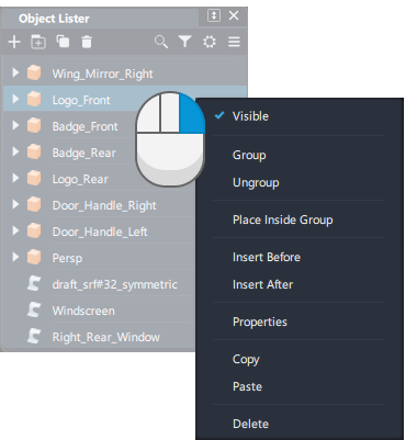

Object Lister context menus - Show by Objects mode
Use the right mouse button on an object to open the menu. The object you are on becomes selected when the menu is accessed.
Visible
Toggles the visibility of the objects selected.
Group
Groups the picked objects into a single object, allowing you to pick and apply transformations to all the components at once.
Ungroup
Separates the components of a group into individually pickable objects.
Place Inside Group
This option becomes active only when right-clicking on a group node. It places the picked objects into this group node.
Insert Before/Insert After
Right-clicking on any object and selecting one of these options, places the already picked object(s) before or after the specific object.
Properties
Opens the Information Window for the object.
Copy
Copies the selected objects to the clipboard.
Paste
Pastes the content of the clipboard onto the layer that contains the object.
Delete
Deletes the selected objects.

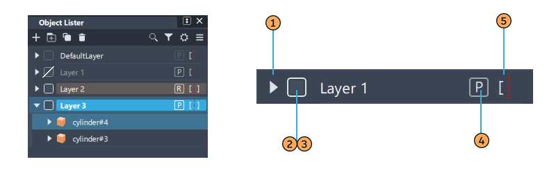

Workflow: Create layers and assign objects
All objects in a scene are assigned to a layer. A Default Layer is always at the top of the Object Lister and cannot be deleted or set to invisible.
Most users add their own layers to organize a model into manageable groups.
To create your own layers and organize your scene geometry
  1. Create a new layer by one of the following methods:
    • Use the icon in the Object Lister icon bar to create a new layer at the bottom of the layer list.
    • Use the RMB context menu > New Layer on any layer to create a new layer below it.
    • Use the toolbar menu > New Layer to create a new layer at the bottom of the layer list.
    • Use the main menu bar > Layers > New Layer to create a new layer at the bottom of the layer list.
    • Select objects in the scene and use the toolbar or RMB menu > New From > New Layer from Selected Objects.
  2. To rename a layer, double click on the layer name and edit the text.
  3. To assign objects to layers, select the objects you want to put onto the layer, and do one of the following:
    • Use the RMB menu > Assign on any layer to put the objects on that layer.
    • Use the toolbar menu > Assign.
    • Use the main menu bar > Layers > Assign Objects.
  4. To make the contents of the layer visible or hidden in-scene, click on the square icon to the left of the layer name.
  5. To set the layer color, use the right mouse button on the visibility square icon to open the color selector.
  6. The arrow to the left of the layer name indicates that objects have been assigned, and clicking on the arrow opens the layer and displays the assigned objects. Using Shift + click on the arrow expands all groups within the layer.

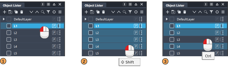

Workflow: Construction layer / active layer
The Construction Layer, also known as the Active Layer, is displayed in a blue highlight color and is the layer where new geometry is placed when it is created.
  • Use the LMB to click on any layer name in the Object Lister to set it to the Construction Layer.
  • Only one layer can be set as the Construction Layer. If you don't know which layer you want as the construction layer, most users set it to the Default Layer.
  • If the wrong layer has been used as a construction layer, simply re-assign the objects to the layers you want afterwards.
  • Setting the Construction Layer also selects the layer. Use Ctrl + LMB to deselect it if required.
  • The Construction Layer color is customizable in the Preferences > Color Themes > Customize window under the UI colors section.

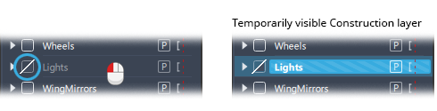

Temporary visible/pickable state for the construction layer
If a layer is set to invisible when clicked on with the LMB, it will be set to the creation layer, and it will temporarily change to a visible, pickable state.
This is displayed with a different construction layer highlight with faint diagonal lines and with the visibility icon shown as off, even though the layer is visible.
When a different construction layer is set, it returns to being invisible.
This can be useful for quickly switching between layers to display different versions:
  1. Make all the layers you want to show alternatives for invisible.
  2. Single LMB click on each layer name to switch between.
Note: If a layer is set to reference or inactive state then when clicked on with the LMB, it is also set to the creation layer, and is temporarily changed to a visible, pickable state.

Workflow: Layer visibility, color, state, and symmetry settings
The icons on each layer entry are the most common settings and provide shortcuts for tools that are also available on the menus.
List all the objects in a layer - Clicking on the arrow opens the layer and shows all the objects as a node list. Click again to close.
Layer contents visibility in-scene - Use the visibility box to the left of the layer name to toggle the objects in scene on and off. Alternatively use the RMB context menu on the layer name, the toolbar menu, or the main layers menu and choose Visible.
Layer color - Use RMB on the visibility box to select a color for the items in the scene that are assigned to that layer.
Layer pick states - Use the icon to cycle between the three pick states:
  • (Pickable) - Makes the selected layers normal.
  • (Reference) - Sets the layers to be visible but not pickable. Use this setting to snap to objects without picking them. Layer background color: brown.
  • (Inactive) - Sets the selected layers to be templated, like objects templated with Display > Template. The objects are visible but not snappable or pickable. Layer background color: light blue.
Layer symmetry - Use the icon to toggle symmetry on and off.

Selecting multiple layers to apply actions
Selecting multiple layers lets you apply operations to all of them in one go, such as deleting, making visible, drag-and-drop, or adding to a folder.
Use the LMB to select a layer. Note that the first LMB click always selects the layer and set it as the Construction Layer. So, make sure that the correct construction layer is re-set afterwards if required.
Use Shift + LMB to select a range of layers.
Use Ctrl + LMB to select or de-select individual layers.
Any shortcut item or menu action applies to all the selected layers.
Set visibility state by scrubbing
You can scrub the layer or object list to quickly turn visibility on or off for many items.
Click and hold on one visibility icon, and then by moving the cursor vertically up or down the list, all items are changed.
Scrub-select is constrained to the hierarchy level of the first selected item and only affects items in that column. The same applies to hierarchy positions in grouped objects.

  • Select the layers that you want to group, and access the menu using RMB on the layer and choose New From Selected > New Folder from Selected Layers.
  • Create a New Folder using the toolbar icon or the menu, and drag-and-drop layers into it using the MMB.
Layer folders can be worked with in the same ways as individual layers, such as renaming and dragging and dropping to reposition, however the following operations apply to all layers within the folder:

Workflow: Show by Objects
When the Object Lister is in Show by Object mode, all the objects in the scene are listed without layers. This is an alternative to using Menu > Windows > SBD to view the object nodes.
Note: Objects can still be viewed when in Show by Layers mode, but they are listed under each layer.
Group nodes and Leaf nodes
When objects are grouped the top node is displayed as an orange cube icon. Clicking on the arrow to the left of the icon opens the next level of the grouping hierarchy. Shift + LMB click on the arrow icon to expand all levels in the hierarchy.
Use the context menu grouping tools to create and modify groups inside the Object Lister.
You can also click an object or node item with the MMB and drag it into or outside of an existing group to add or remove it from that group.
Object list ordering
Canvases and Construction Entities are always grouped together at the top of the list when Filter > Sort by is set to Hierarchy:
Re-ordering nodes
Drag and drop works for re-ordering objects in the list when Filter > Sort by is set to Hierarchy.
Workflow: History Tools for Objects
Objects with history are displayed with an 'H' icon when viewing objects in either Show by Objects mode, or by opening the contents of a layer.
  • - Object has construction history.
  • - Object has construction history which is temporarily suspended.
Use the left mouse button on the 'H' icon to display the History menu:
  • Suspend - Temporarily suspends updates of construction history to improve performance. Select again to re-activate history updates.
  • History Visualizer - Opens the History Visualizer window. If the window is already open, selecting this closes it.
  • History View - Opens the History View window. If the window is already open, selecting this closes it.
H inactivated when a tool is open
Clicking on the 'H' does not show the fly-out when the user is in a modelling tool as it is actively being used to make changes to the geometry.
