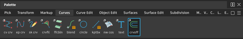

Access this tool from the Curves tool palette:
Curve & COS Offset Control

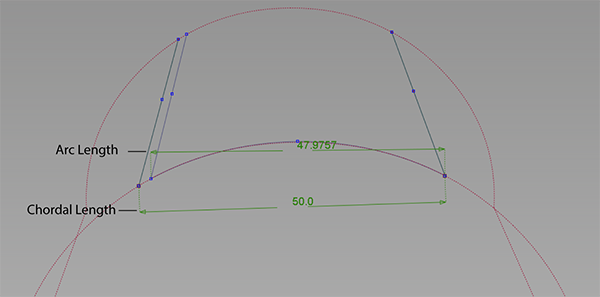

Offset Measure
Specifies the method used to measure the Offset Distance. These options are only available when the input is a surface edge, curve on surface, surface span, or isoparm. It is not available when offsetting a Curve.
Chordal Length – Offset distance is based on the shortest linear distance between input and offset output. Use this option when you want a linear offset distance. Chordal Length is the default method.
Arc Length - Offset distance is based on the arc length of the input surface. Use Arc Length when you want the offset length measured on the surface length.

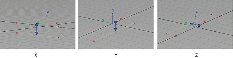

Offset Plane
X, Y, Z
Applies an offset that is perpendicular to the direction of the specified plane's normal direction. For example, selecting X generates an offset that is parallel to the X plane.
View
The offset is created according to the plane that is parallel to the camera view.
Picked
The offset is created according to the vector that you pick in the viewport.
Auto
The offset plane is automatically calculated.

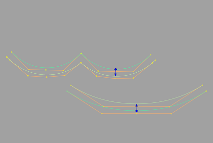

Offset a curve using the Curve & COS Offset tool
  1. Select the tool.
  2. Pick the curve you want to offset. The offset appears in a different color than the picked curve with an arrow indicating the direction of the offset. The image below displays offsets of multiple curve and an offset of single curve.
  3. Do any of the following:
    • Drag the arrow left and right using the to change the offset distance. You can also change the offset direction by dragging the arrow head or clicking the base of the arrow.
    • In the Curve & COS Offset Control window, type a number or use the slider to set the Offset Distance exactly and specify other options for the offset.
      Note: You can specify a positive or negative Offset Distance value to create a curve offset on either side of the original curve.
    • Specify whether you want the Offset Distance to be measured by chordal length or arc length by setting the Offset Measure option. For more information, see Offset Measure.
    • Select additional curves (or de-select them) by holding the key while clicking them or using a pick box.
